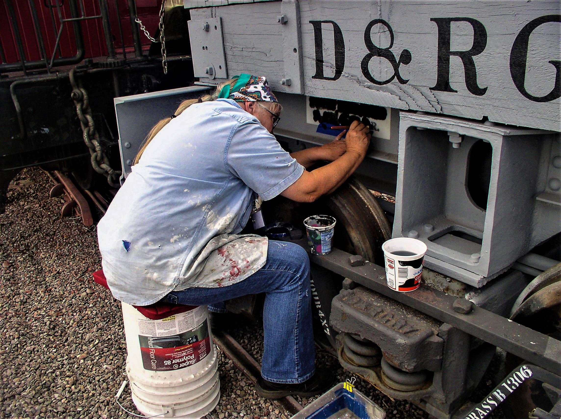

2018-09-25 Stenciling goes on a piece, based on colour, of MoW equipment.jpg

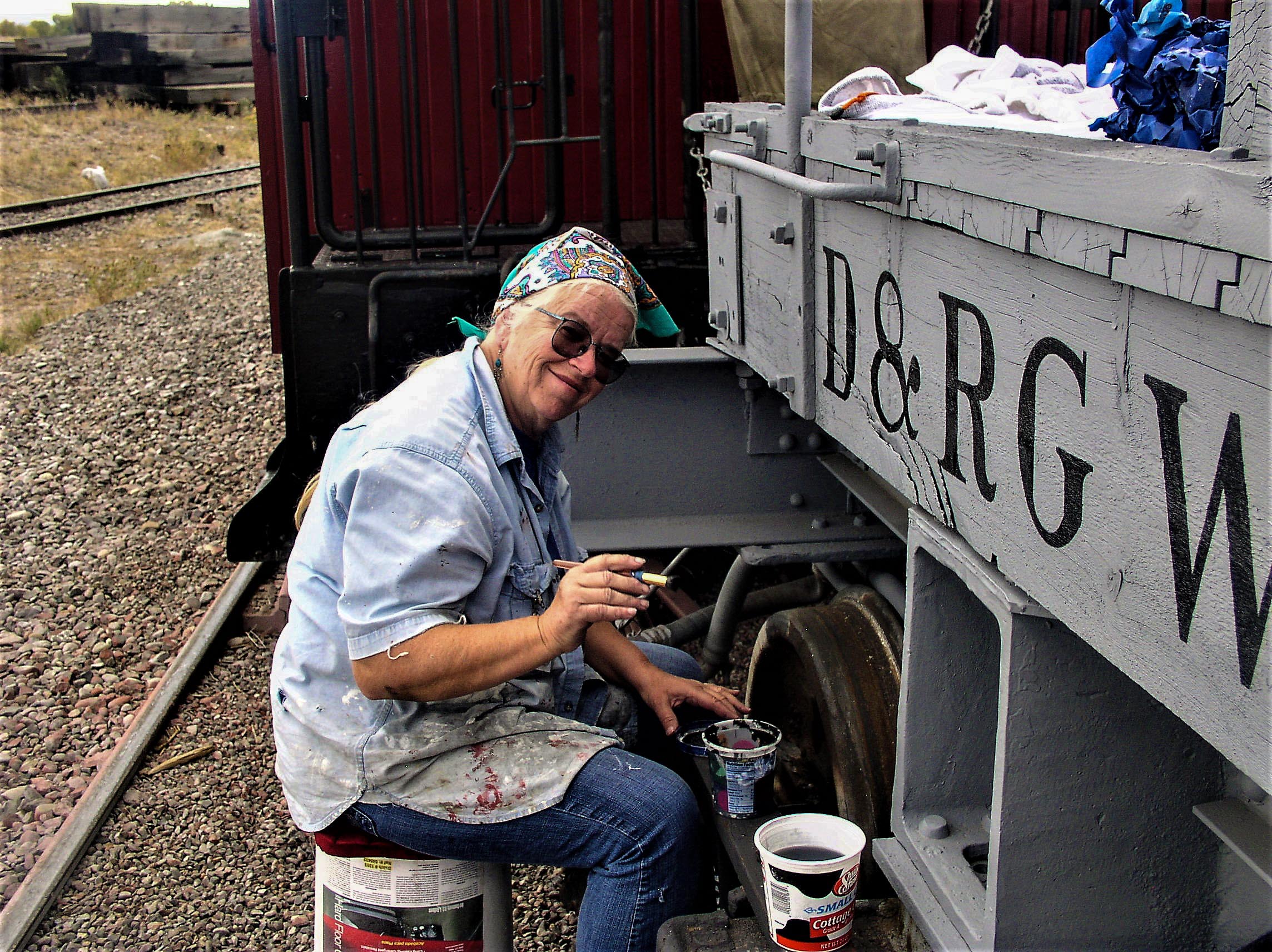

The camera gets a smile from the lady doing the stenciling

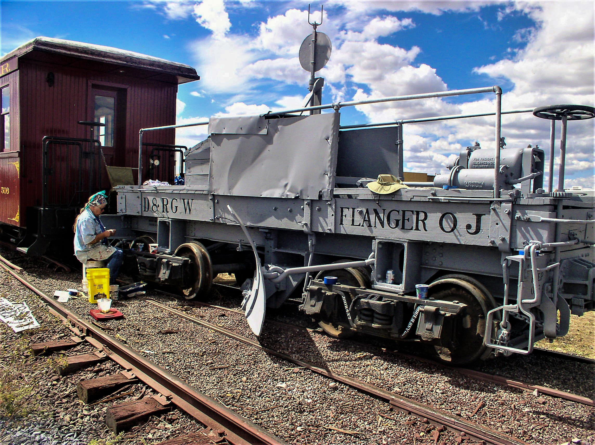

Another shot of her working on OJ
We now see her finished work on flanger OJ

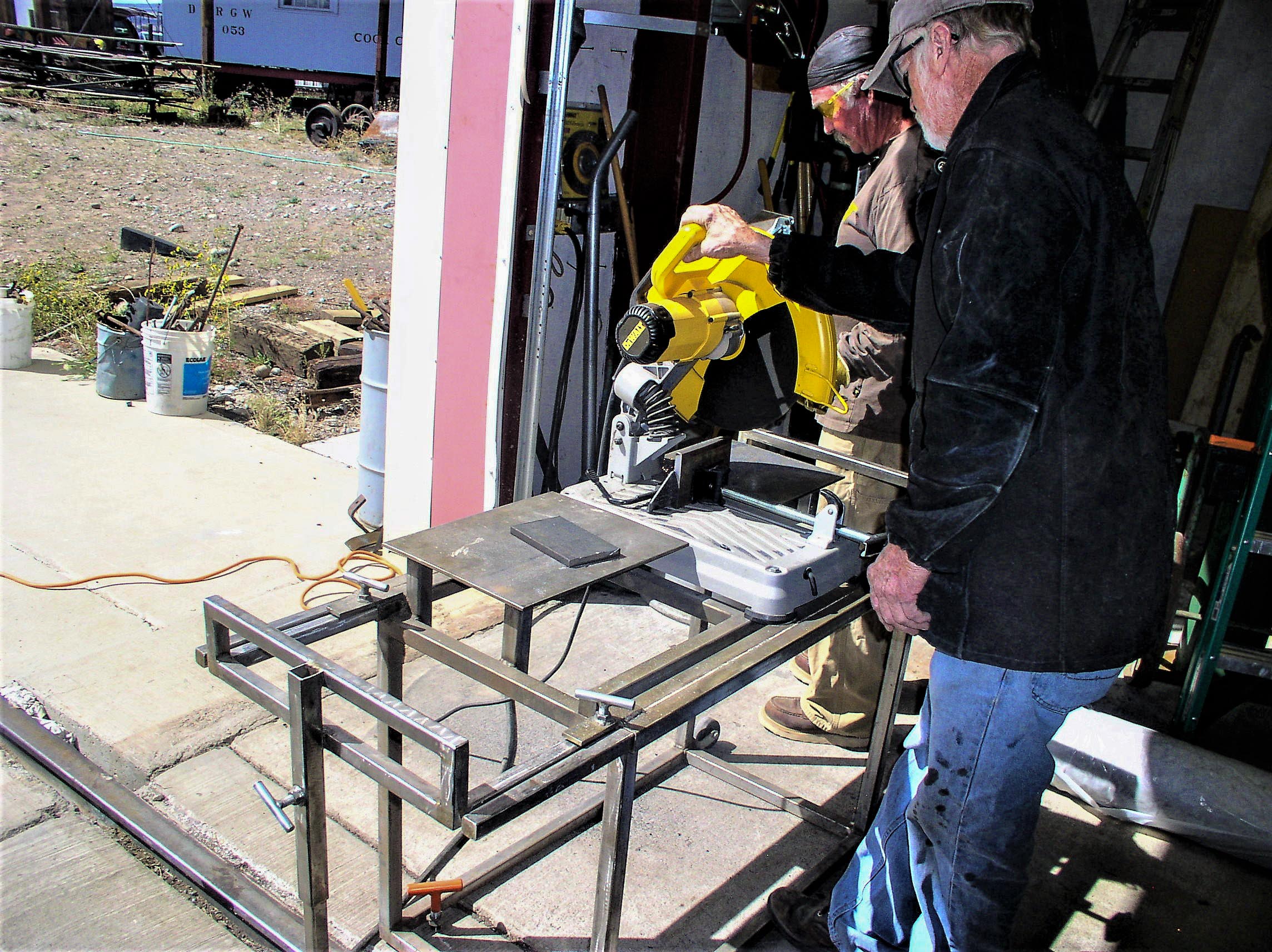

Fabricating necessary parts

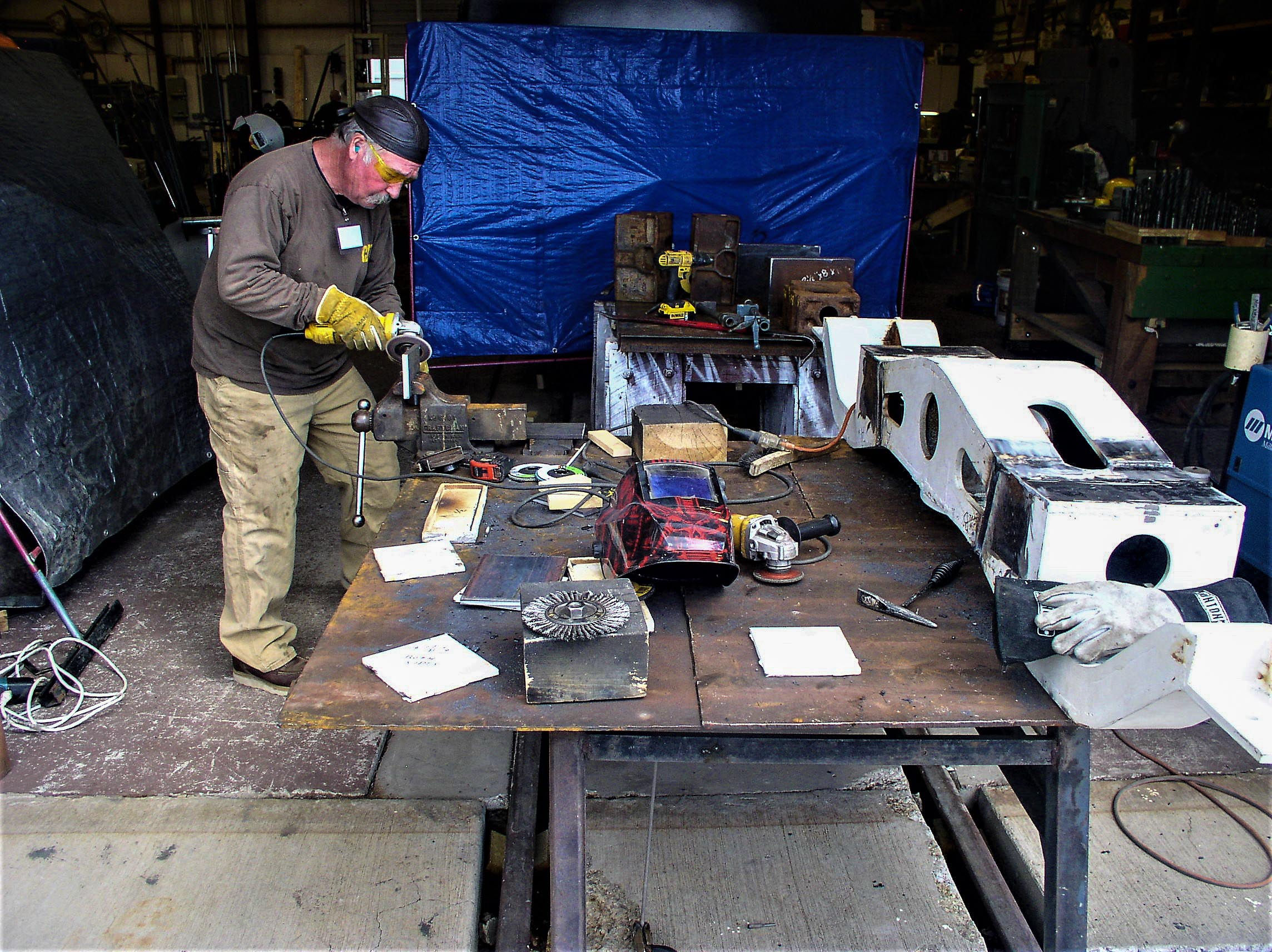

Using an angle grinder to clean up a part

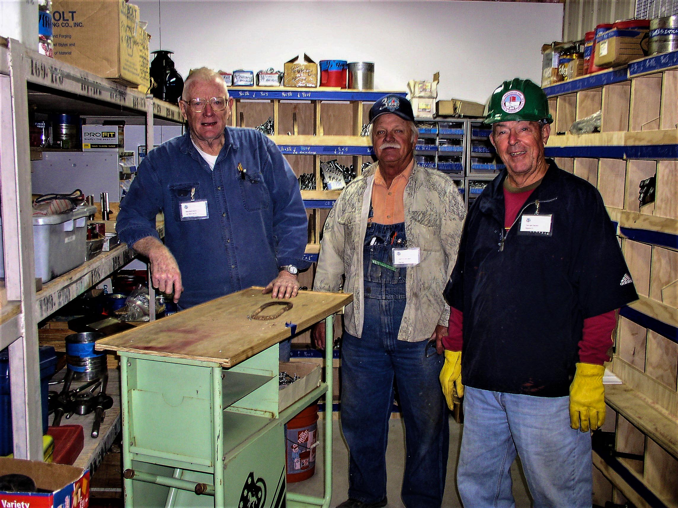

2018-09-25 Some of the crew in the stock room getting supplies for their tasks.jpg

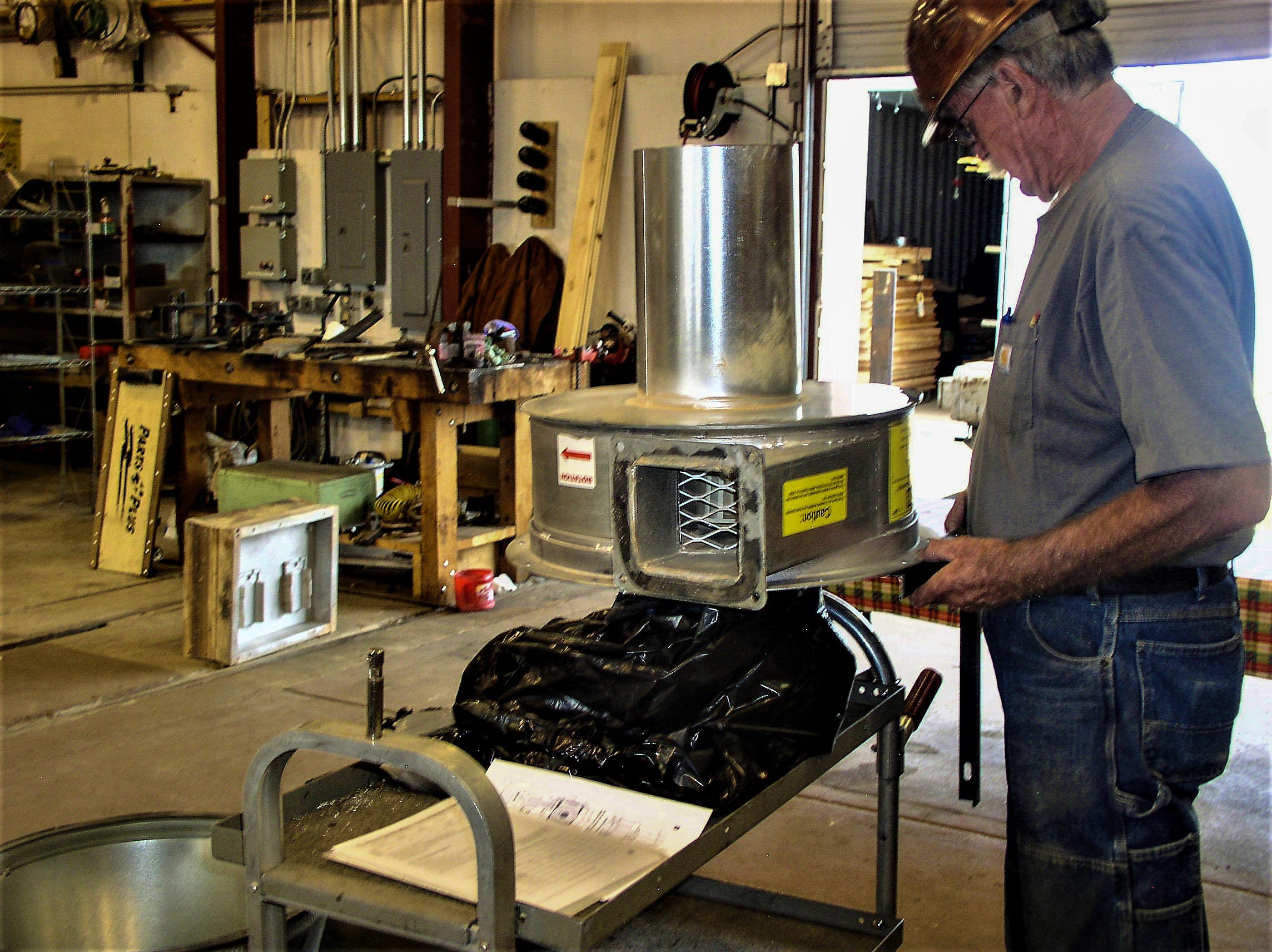

This looks like some type of blower

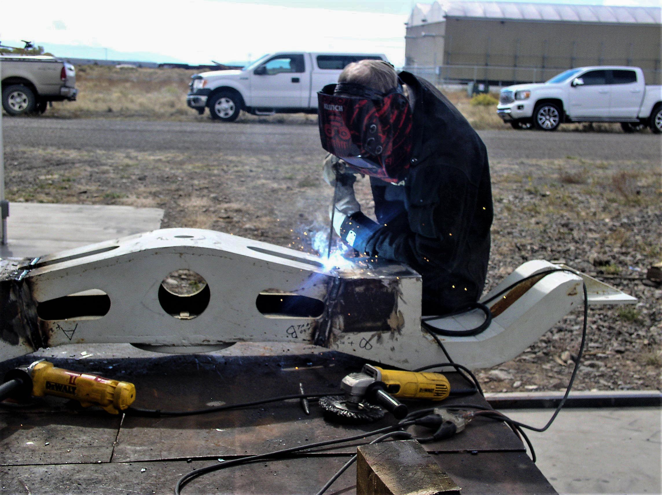

Welding on the frame

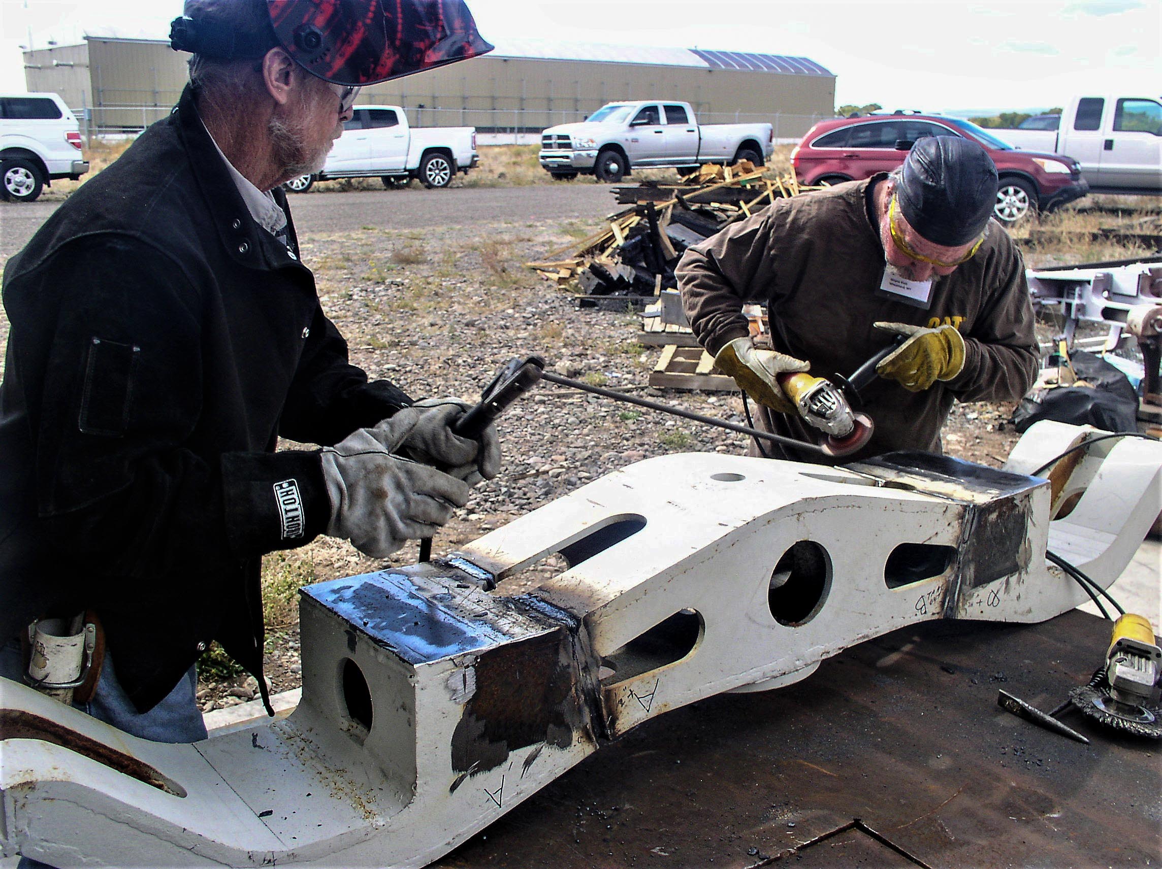

2018-09-25 Some welding has been done on this truck frame and they are cleaning up.jpg

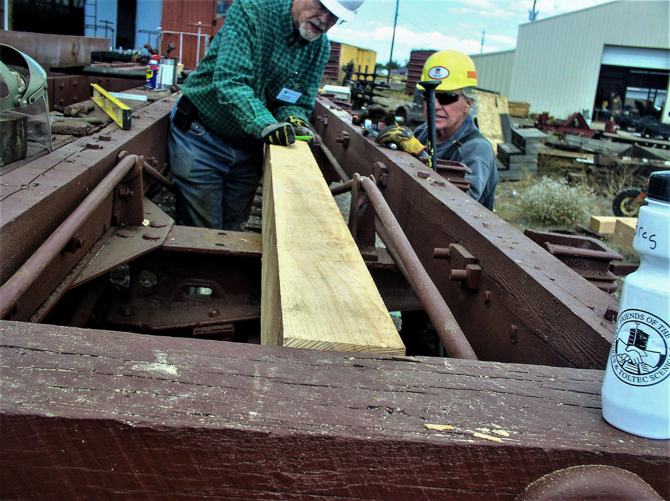

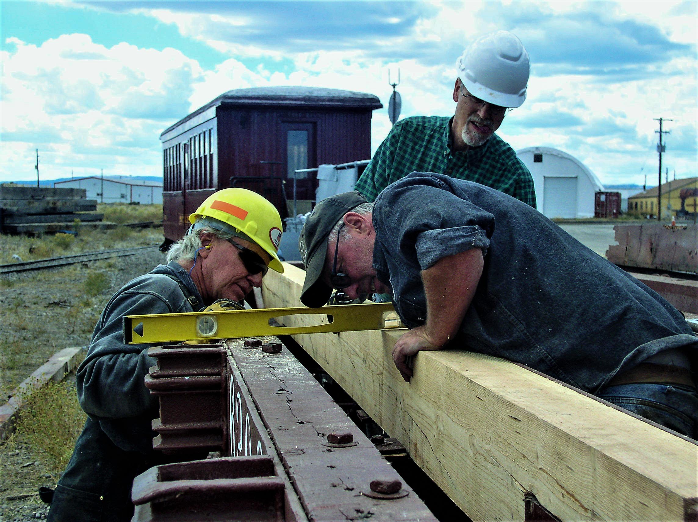

2018-09-25 Well I was correct yesterday, this is a flat car, 6200, these guys are working on here as they measure on a framing member.jpg
They have now got the new framing member in place

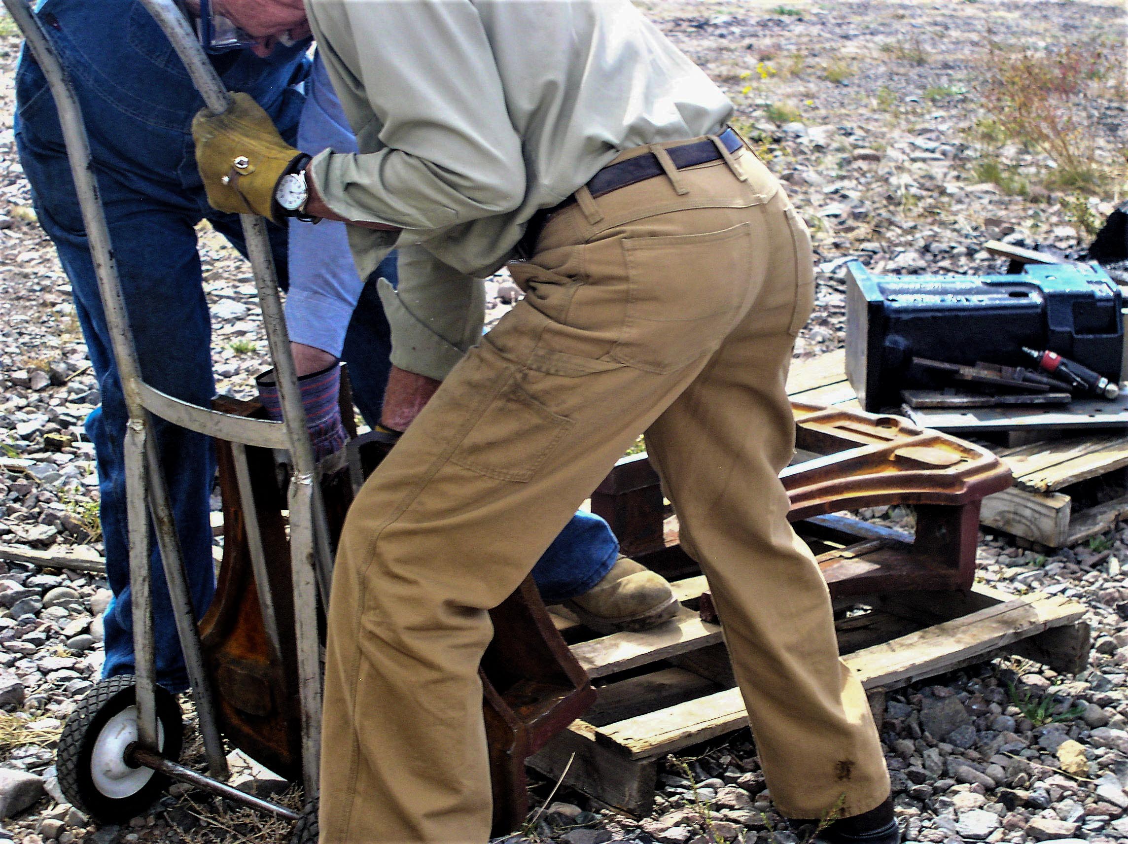

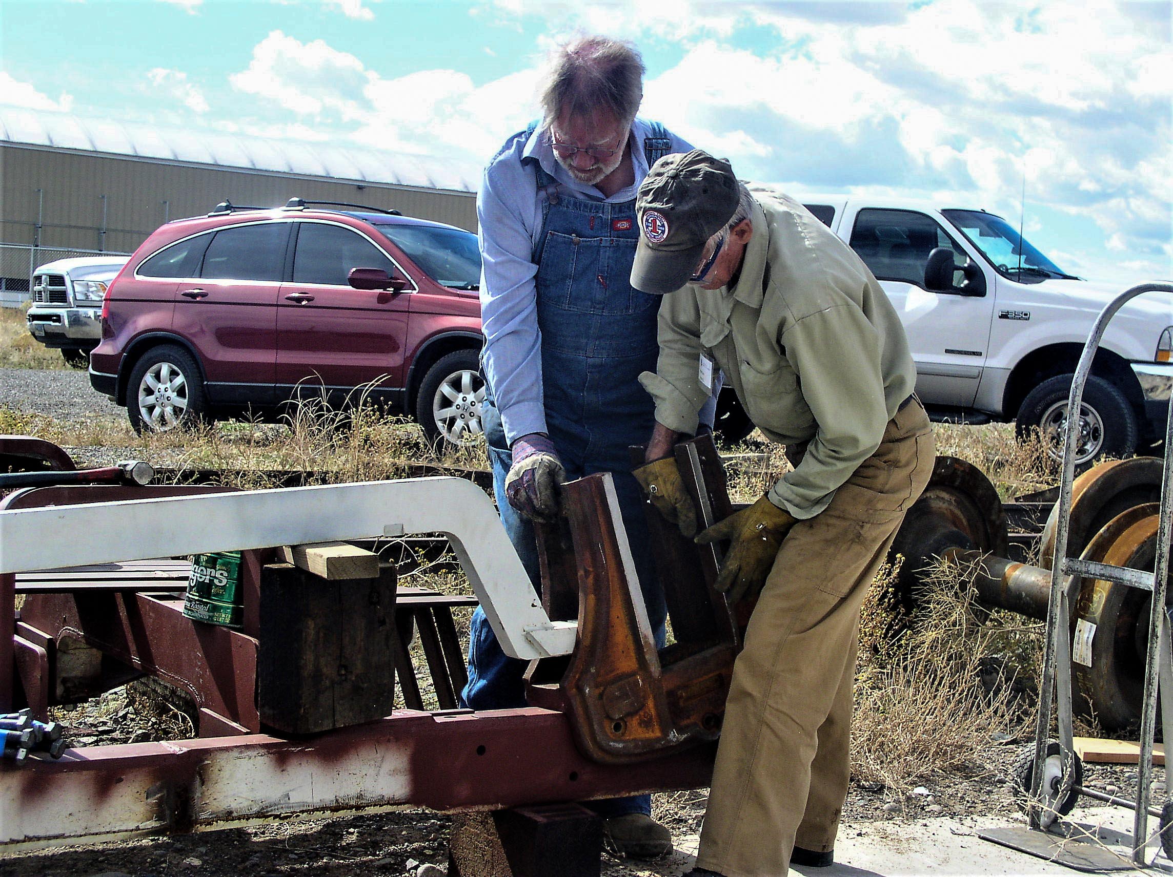

Loading a coupler pocket onto a handtruck

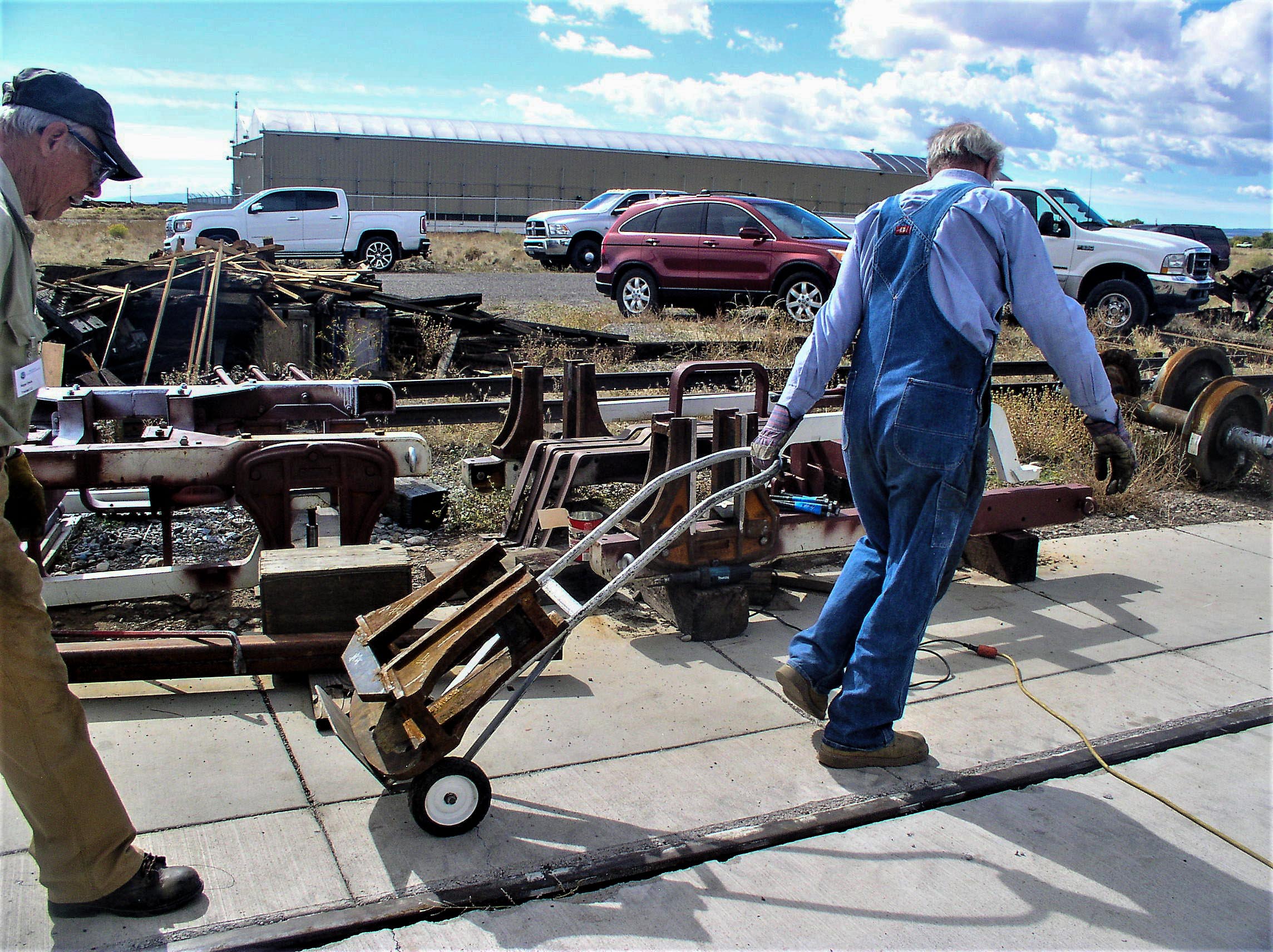

Hauling it to where its needed

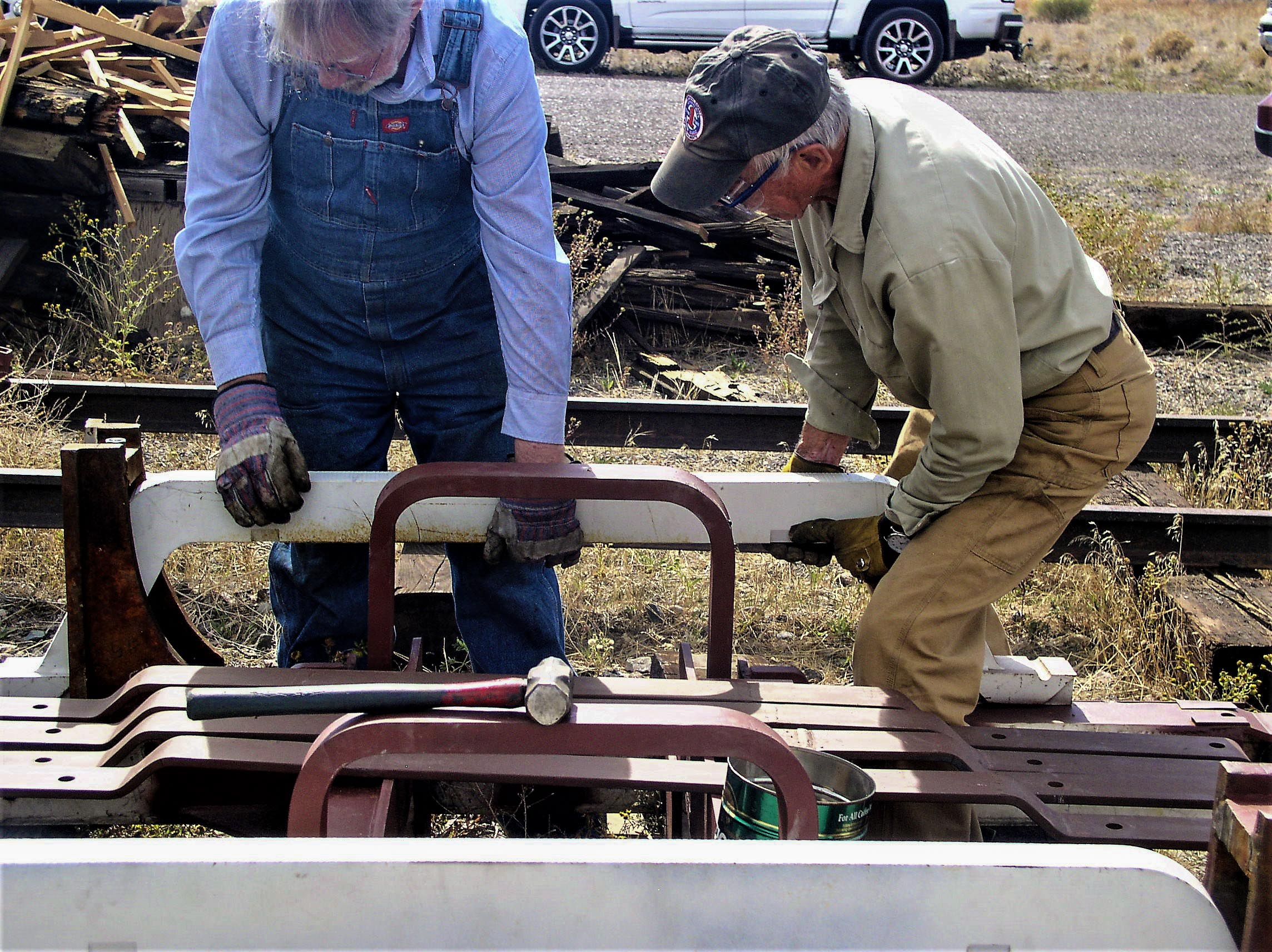

They are placing it onto maybe an end frame member

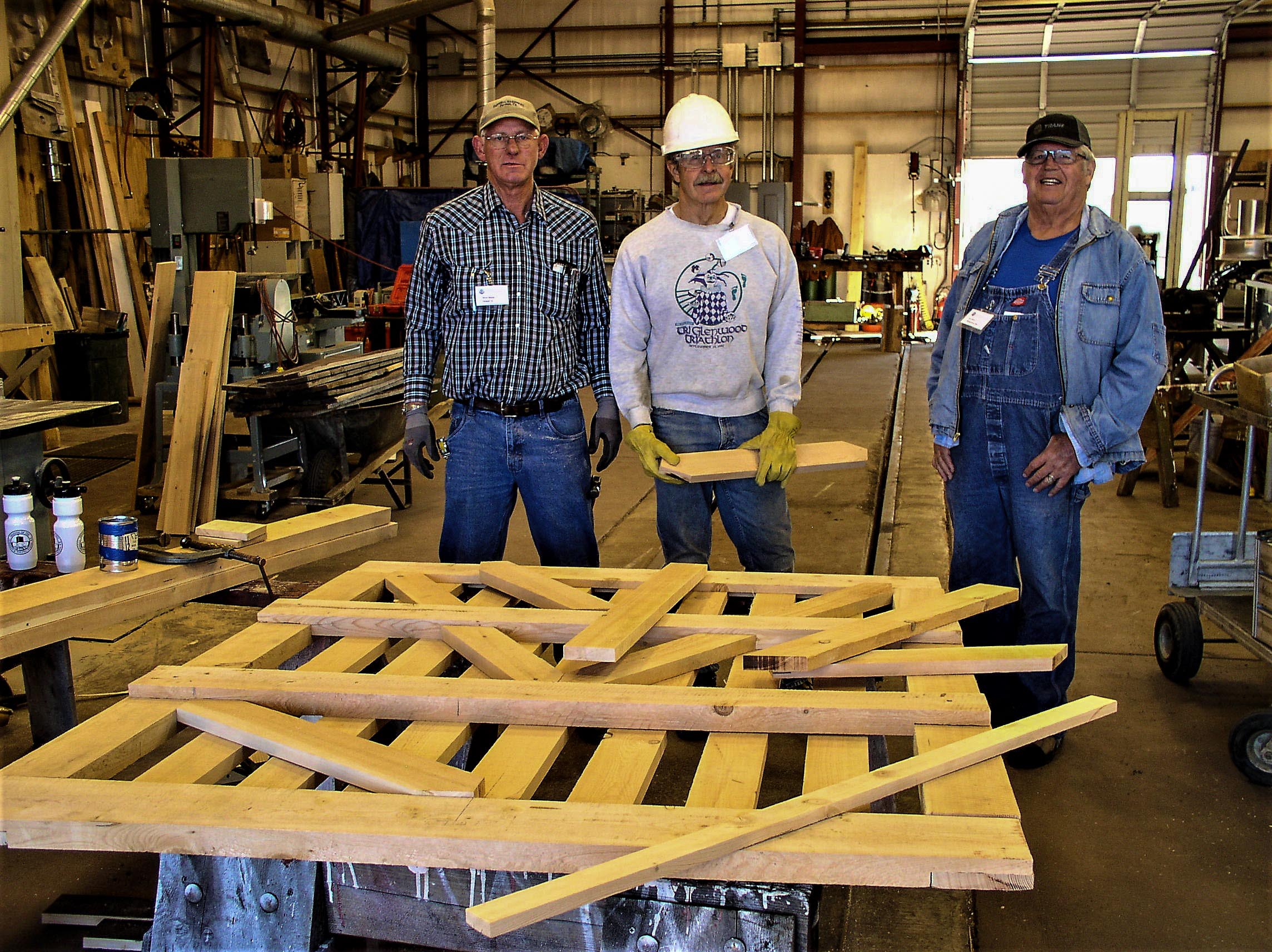

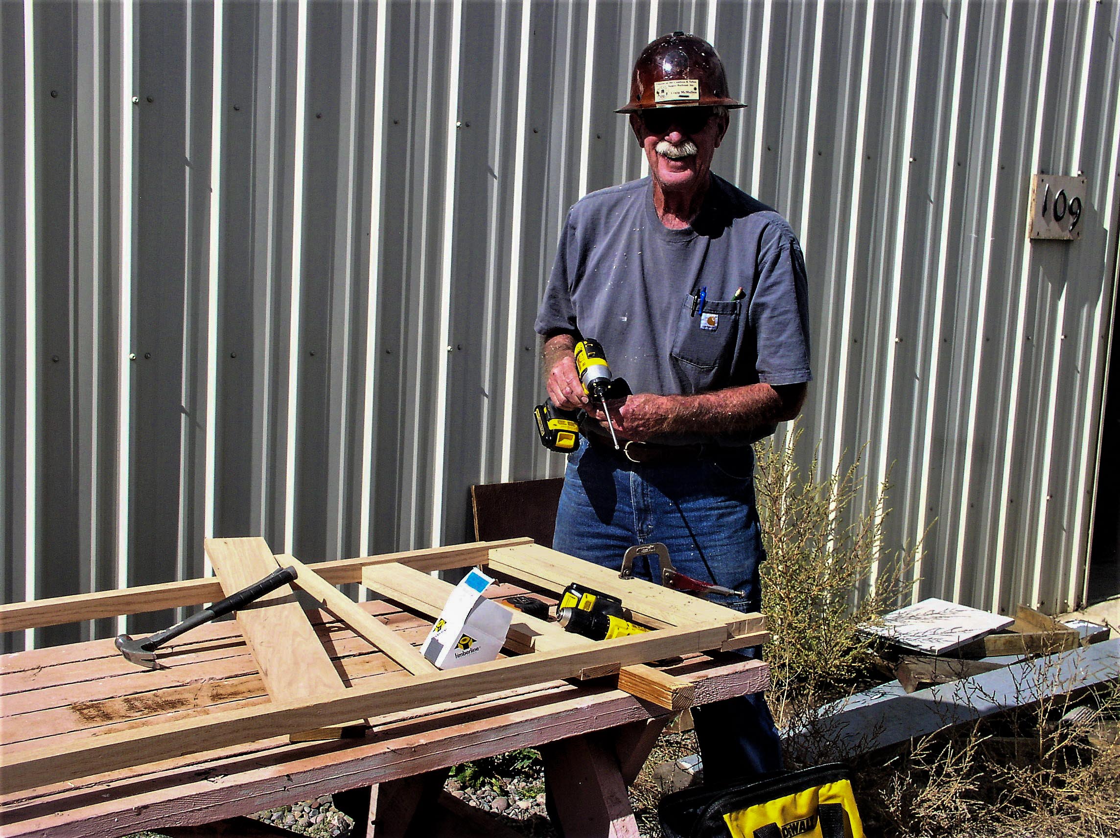

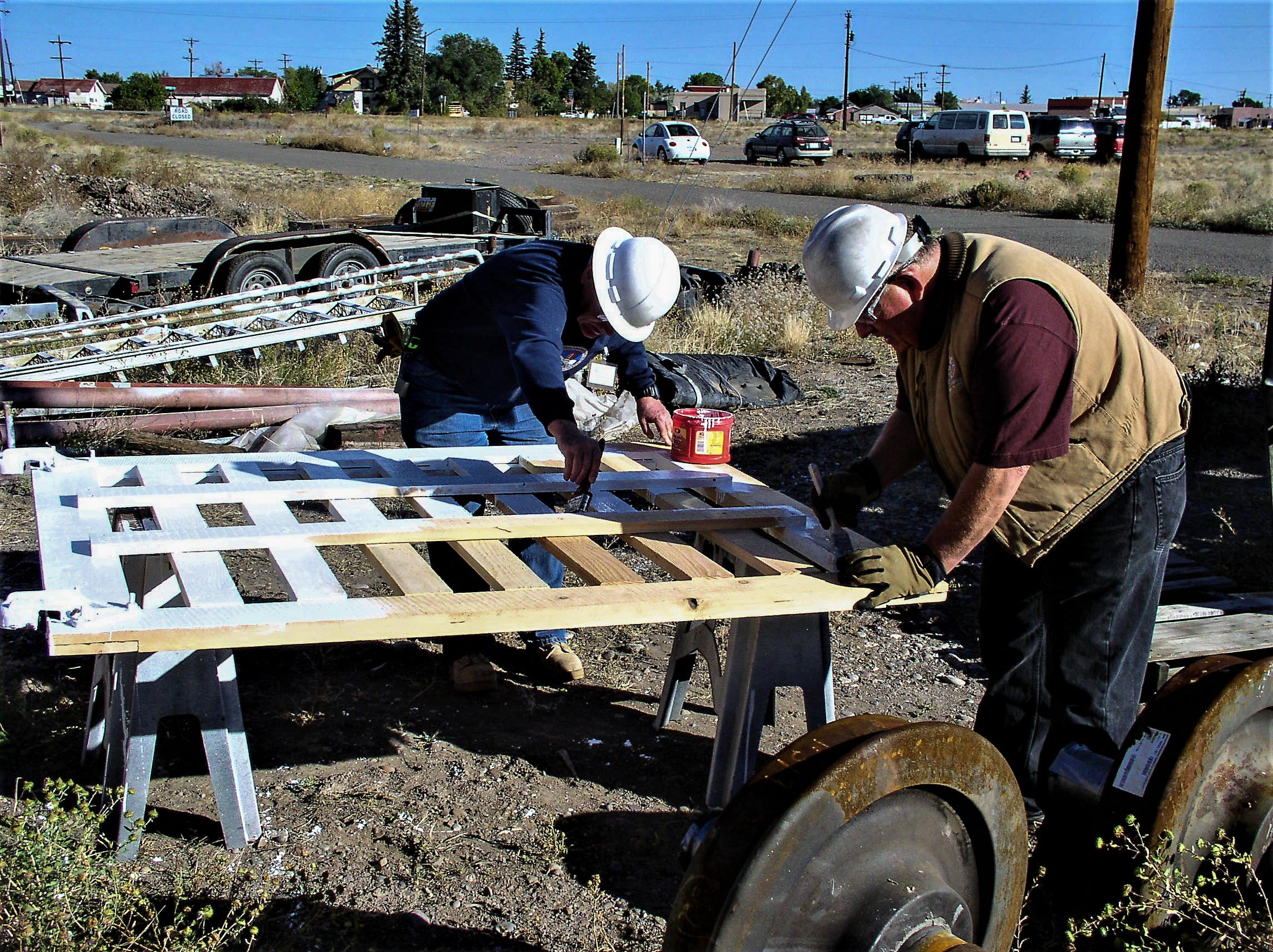

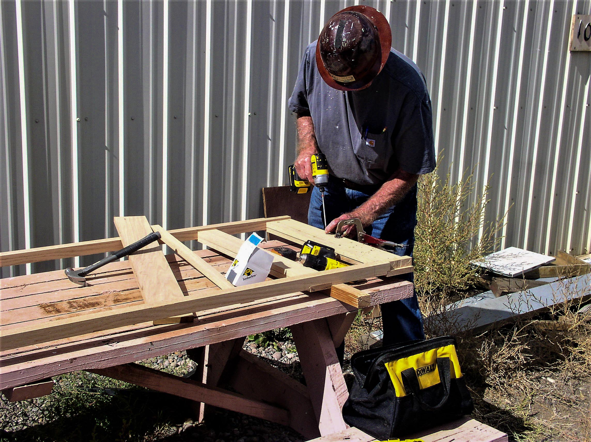

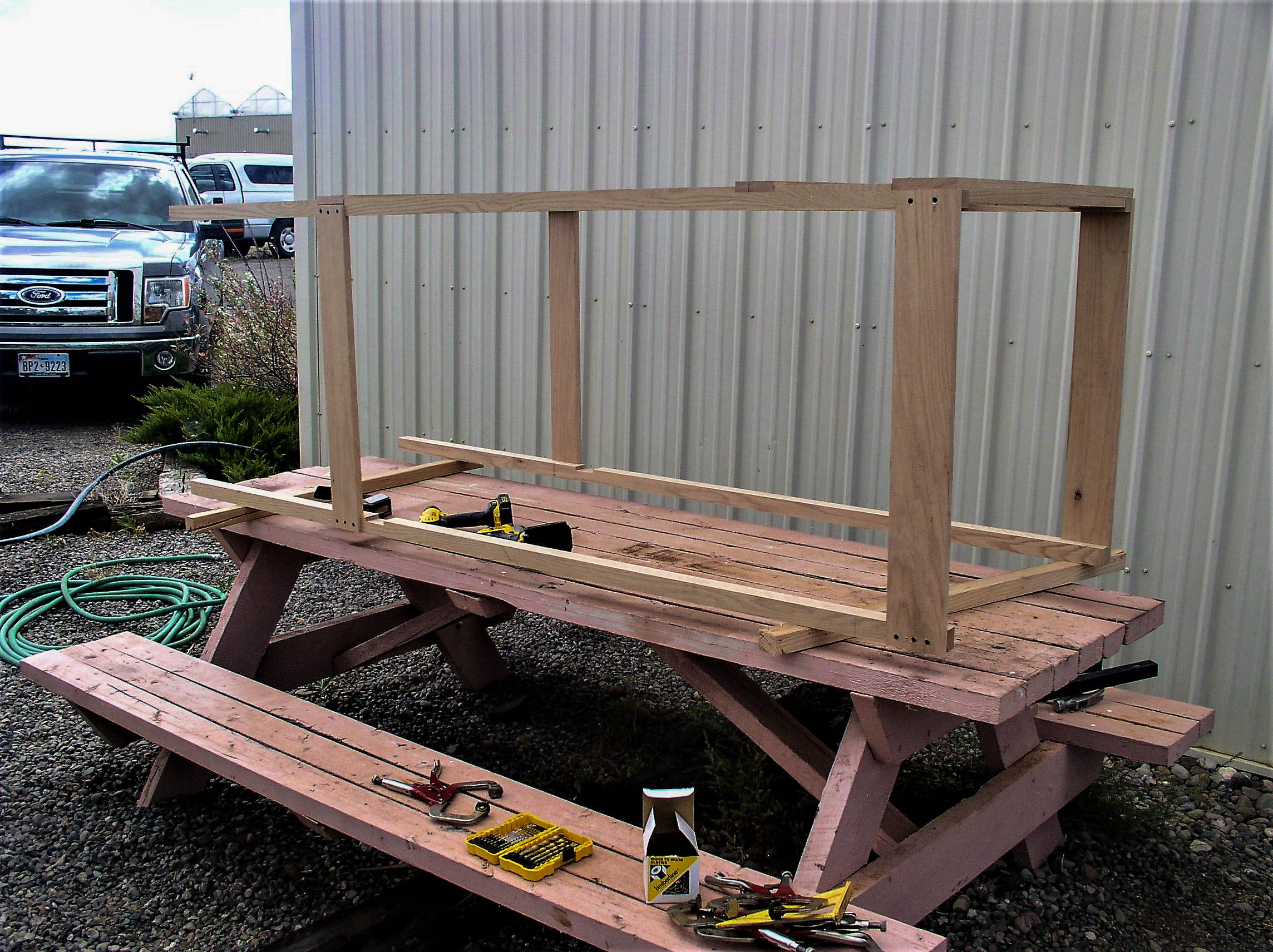

Placing the cross bracing on the new door

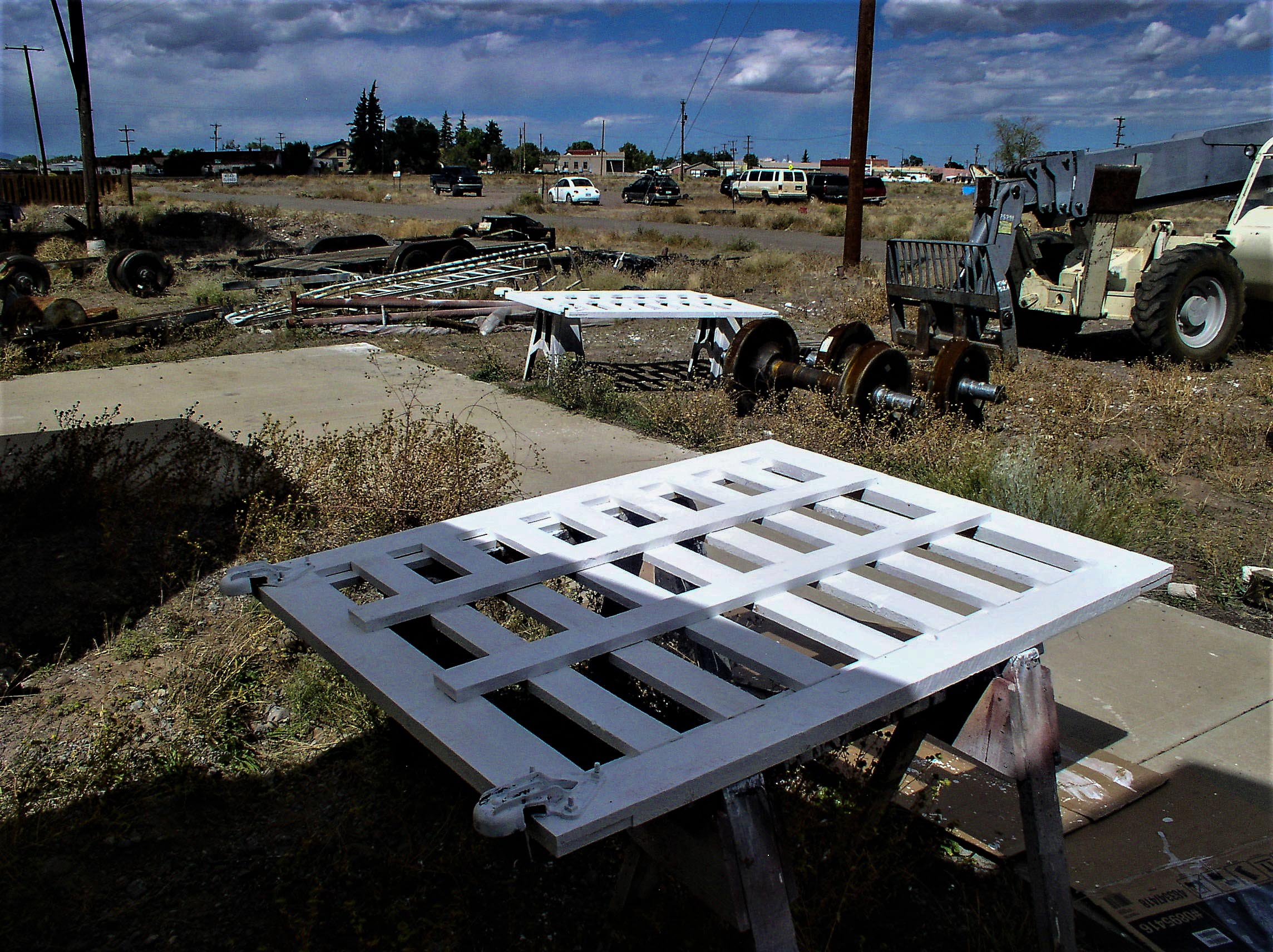

The new car door is primed and ready for its final coat

not a coupler on hand truck but a pedestal box.

The photos of Roy and Wayne welding on the trucks is because the plans had the crossmember 1 1/2" too long. Roy and Wayne had to cut all that steel and narrow it down 3/4" of both sides and weld it back together. For most of us that would have been a road block, but Roy and Wayne sure know how to weld.
Those stock car doors are for the car already painted RGS colors, and will help the car look more authentic in a charter.
