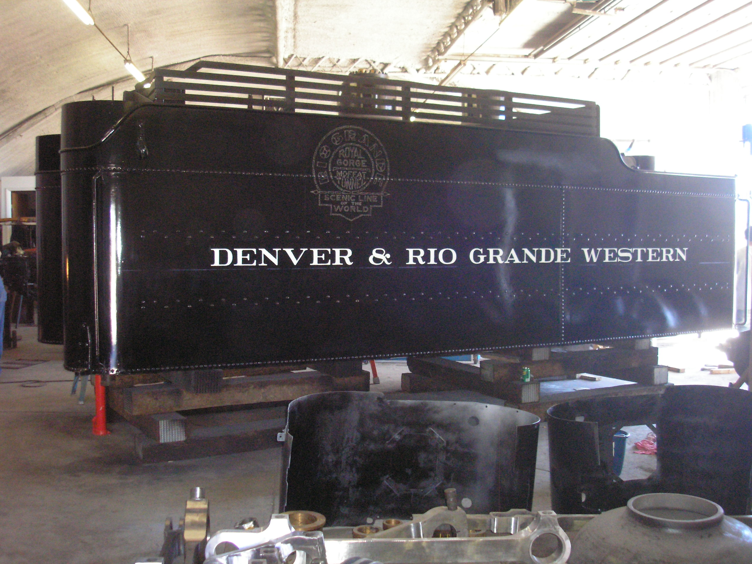

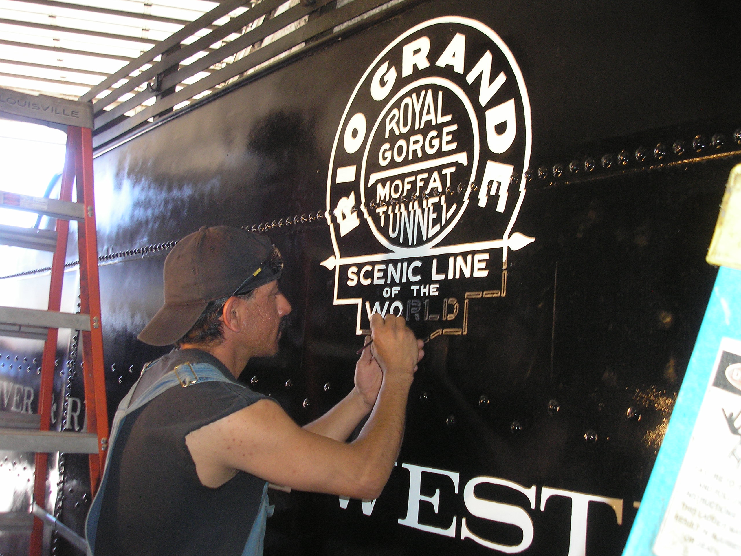

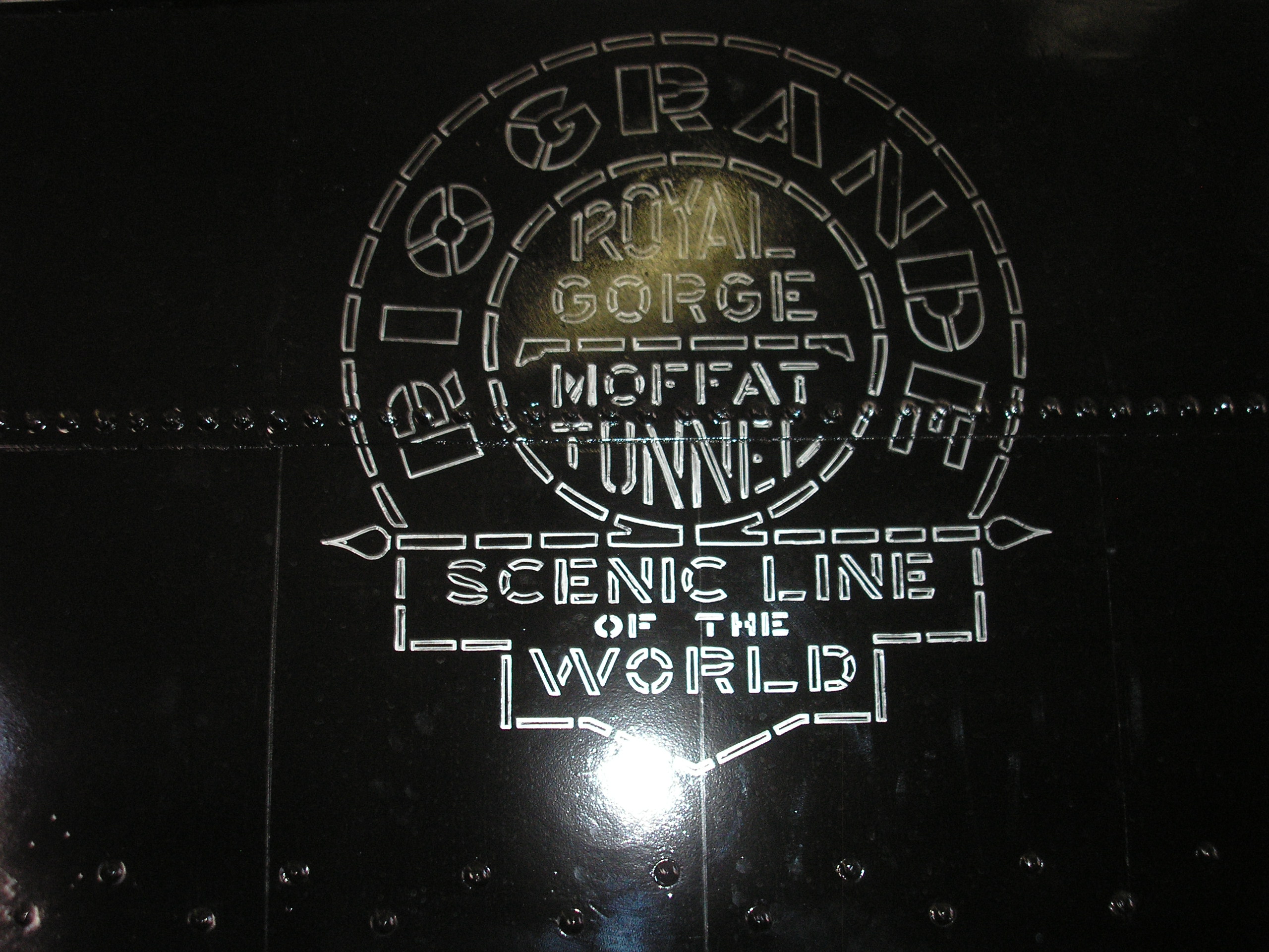

Some lettering was being done to the tender. Excellent workmanship and attention to detail.

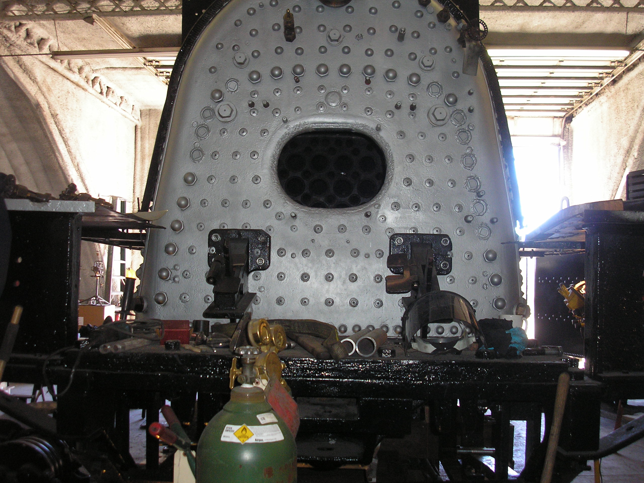

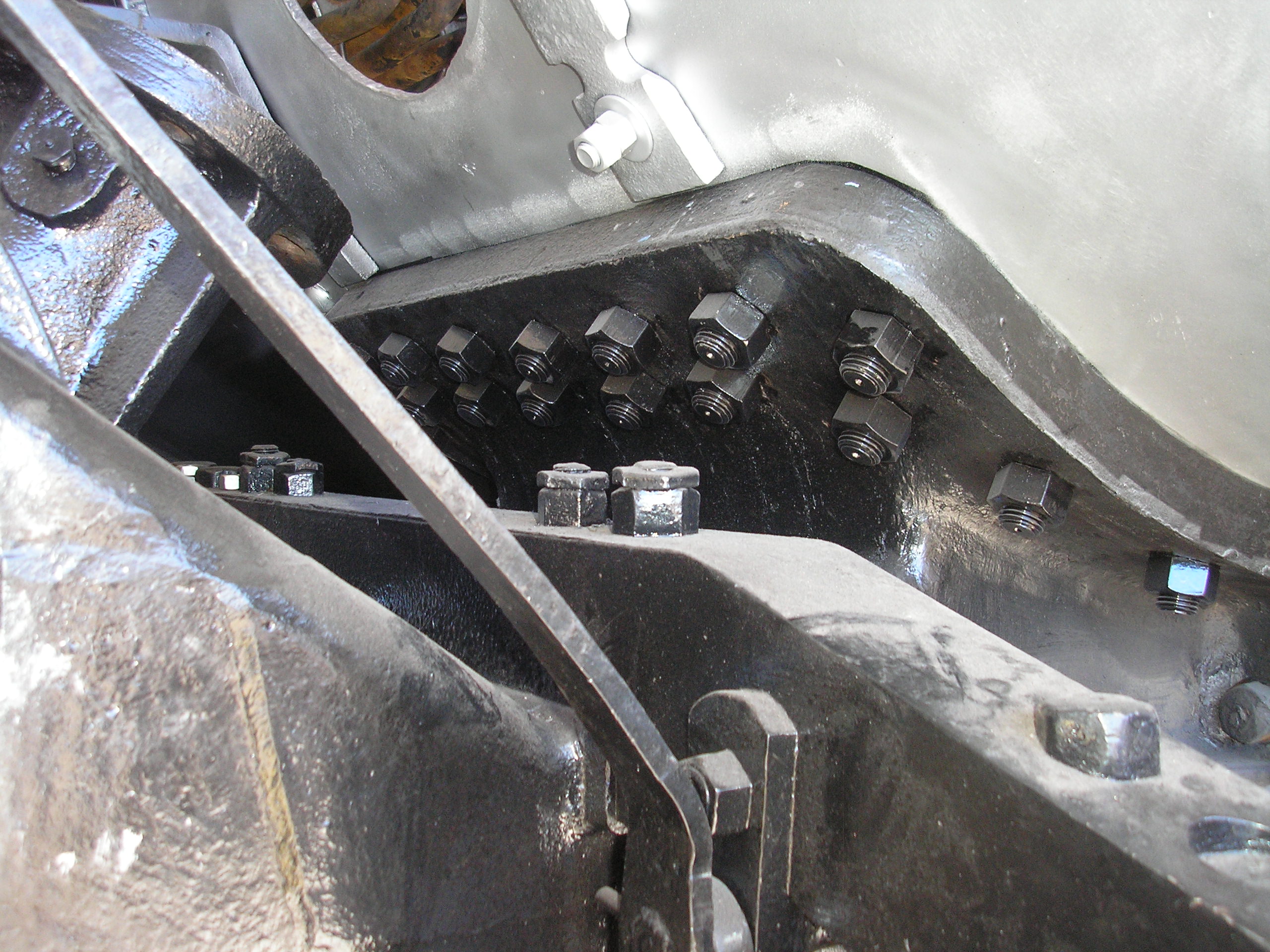

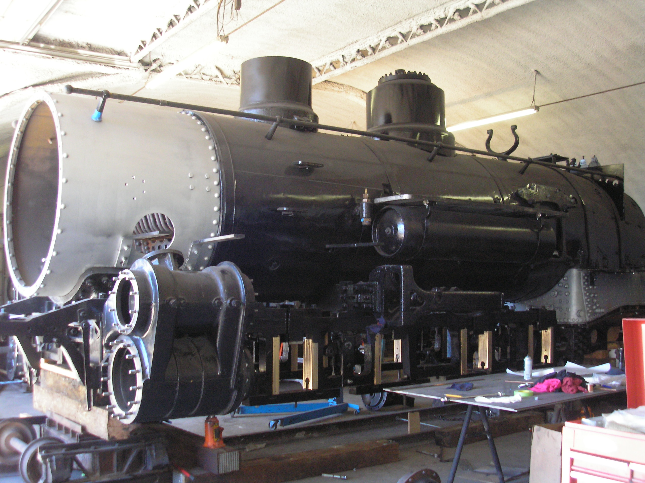

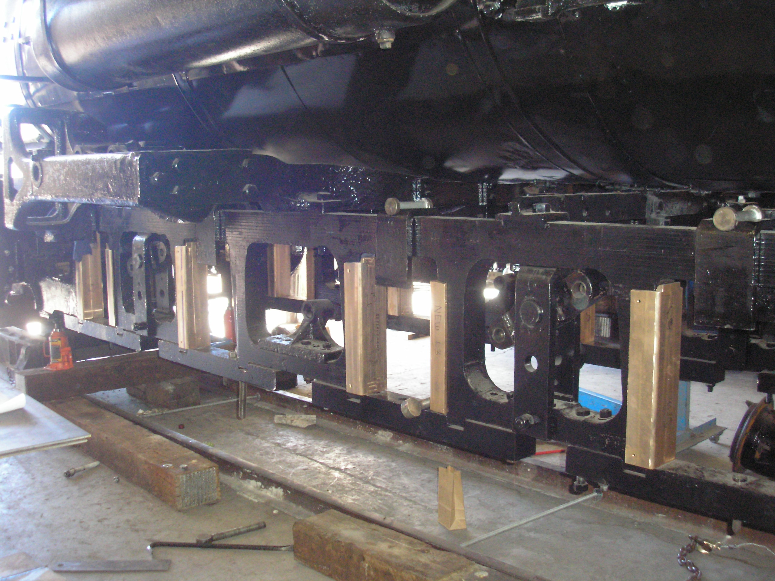

Workmanship on the locomotive is museum quality. Looks too pretty to get dirty with a coal fire. :smiley24:

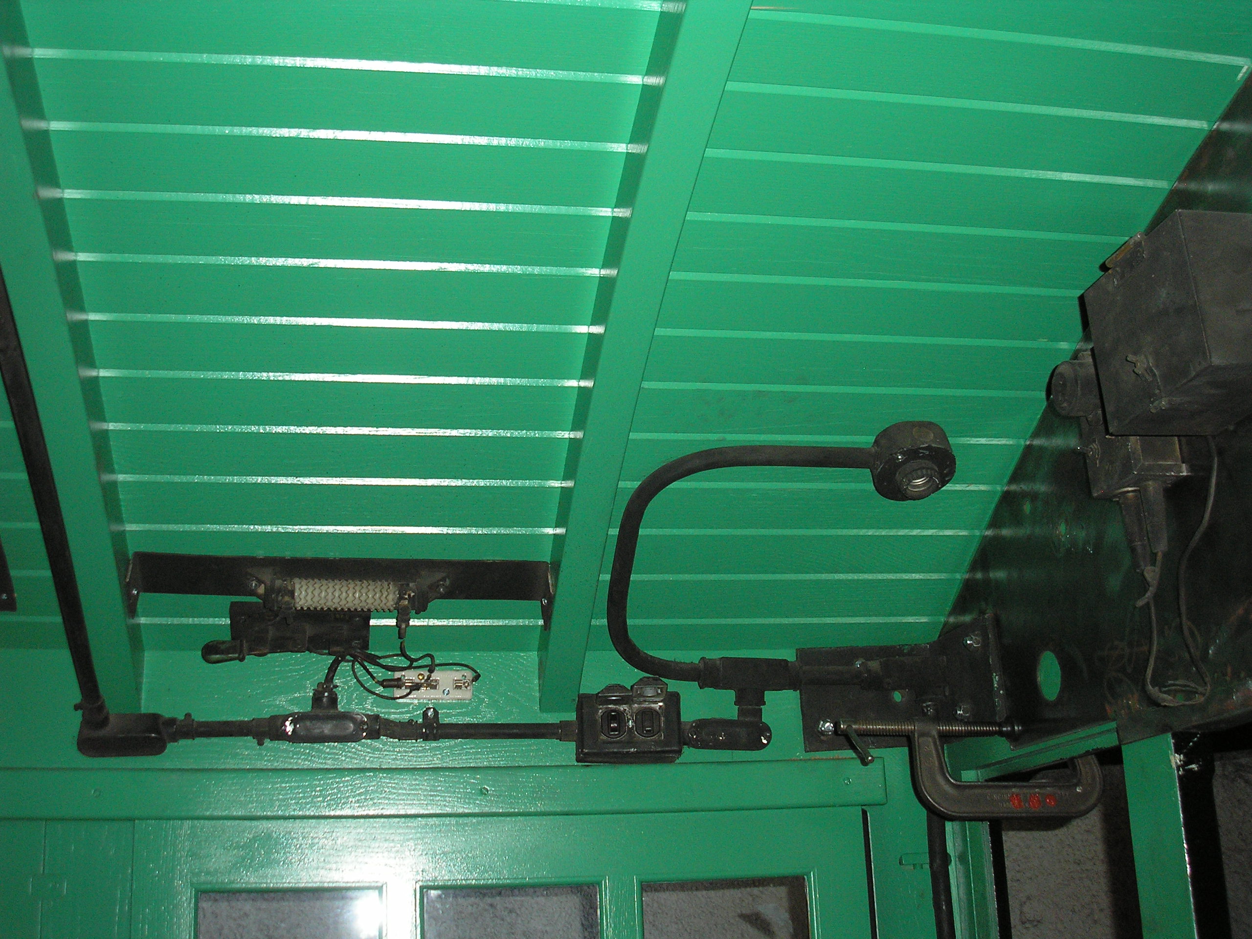

The cab is painted and even wired.

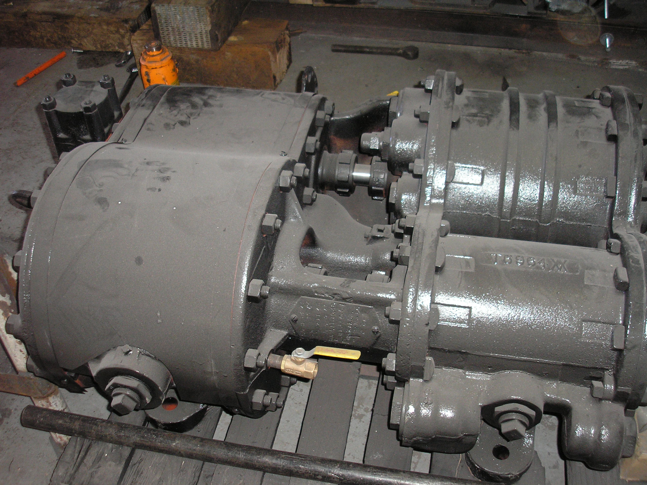

Compressor is rebuilt and ready to install

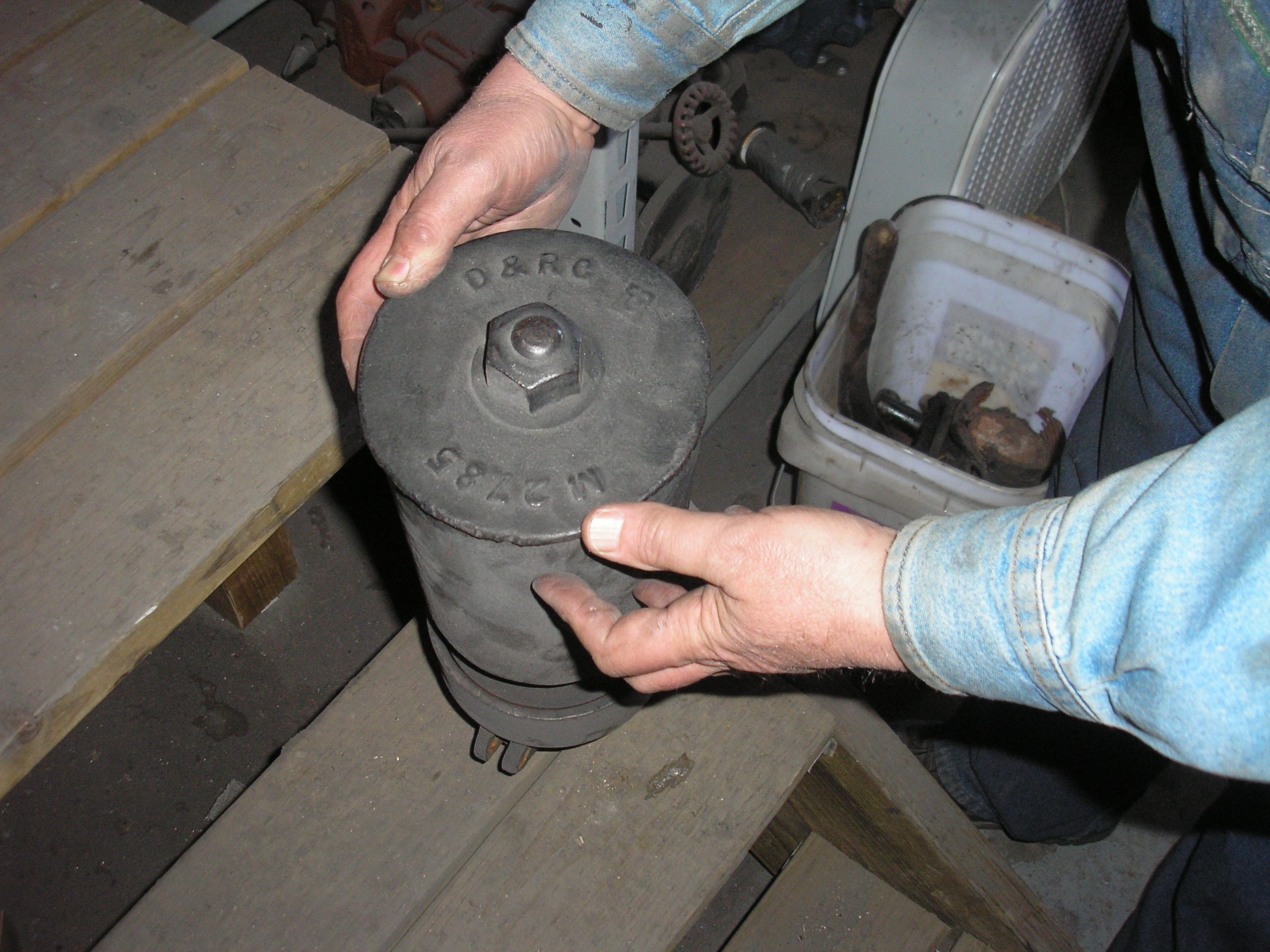

Top view of the whistle. The whistle is a single chime.

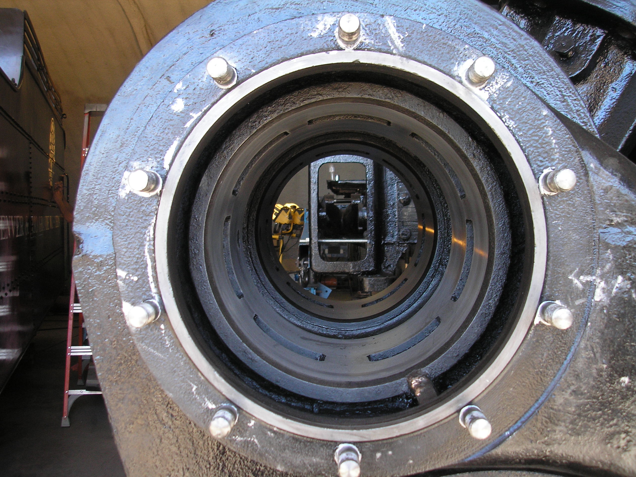

An inside view of a K-27 valve

Dick, you are right. It's obvious this more than a simple rebuild. A lot things that were done over the years are being corrected. For instance, the boiler is able to expand the way it should over the frame. The boiler used to be welded to the frame. Very obvious the pride in workmanship and attention to detail. The attention to detail will ensure 463 is running for another 100 years.

OK, I'll bite. In the interior cab roof photo there is a voltage dropping resistor. Could someone tell me what it's being used in conjunction with? :-?

Its for the headlight so they can dim either the headlight or the tender light depending which way they are going. We were able to locate over 8 dozen 250 watt, 32 volt headlight bulbs that were new origional stock Westinghouse and GE brand a few years ago. What a find! They don't have many 32 volt headlights at Home Depot these days.
