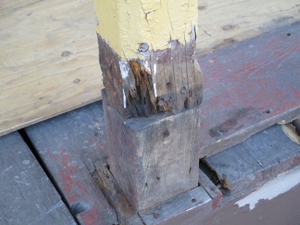

This is a typical, old repair on the Section House porch post. This will be replaced along with the remaining porch in 2015.

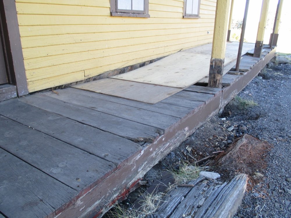

The Section House porch is in really bad shape. Note the line with the wall where the porch collapsed enough to give Bob a real start. Needless to say, replacement is on the menu for 2015.

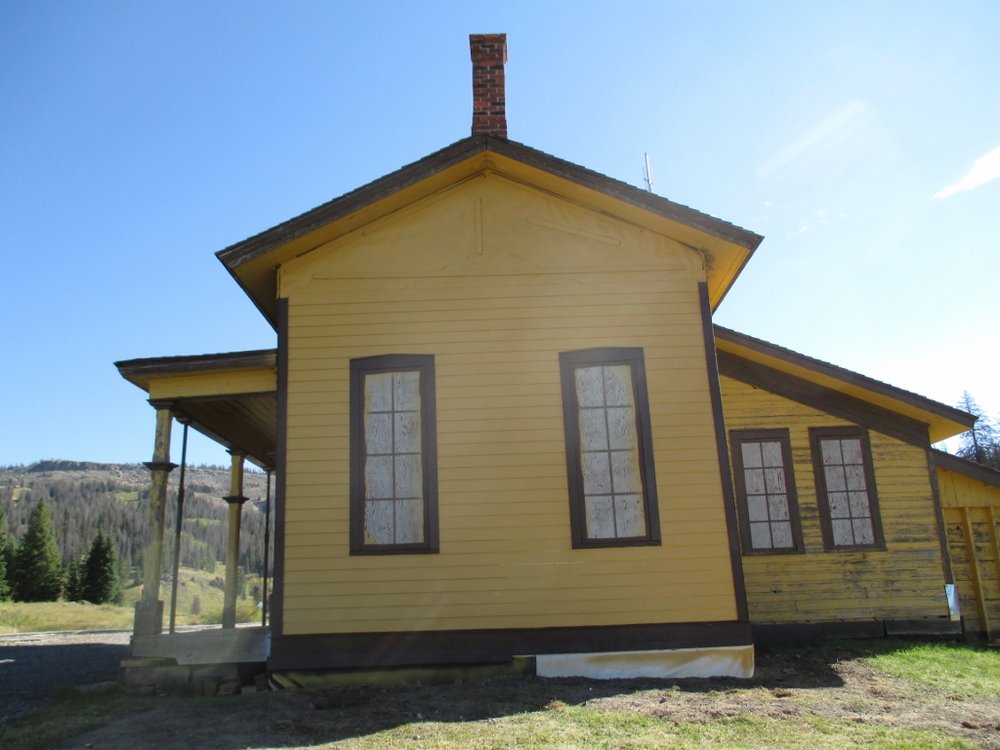

The North west face of the Section House received new siding (up to the roof line) and a coat of paint. Compare with the old South-west siding. Note that the foundation was covered and back-filled for winter, but will have to be re-excavated for continuing leveling of the structure next year.
