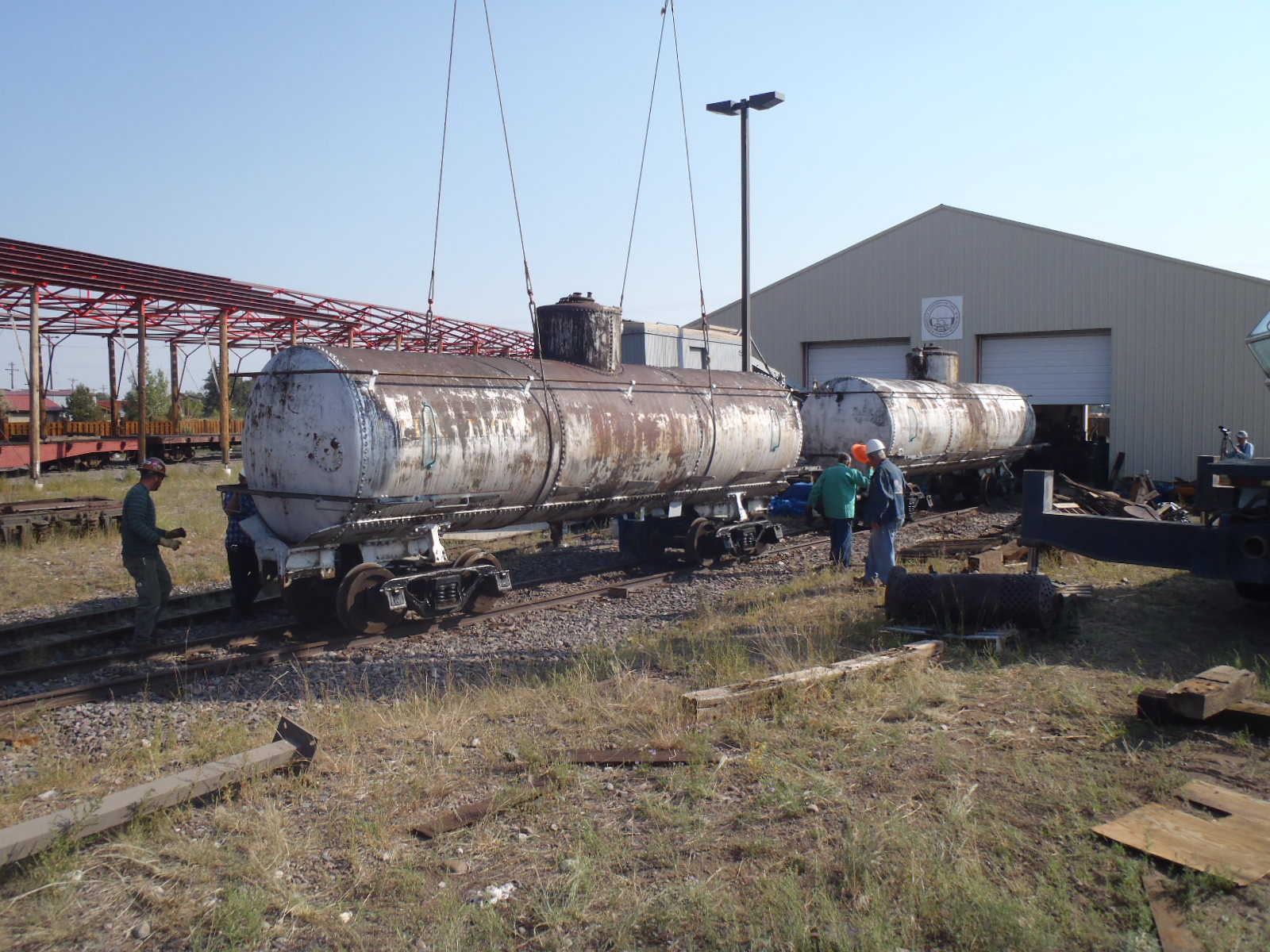

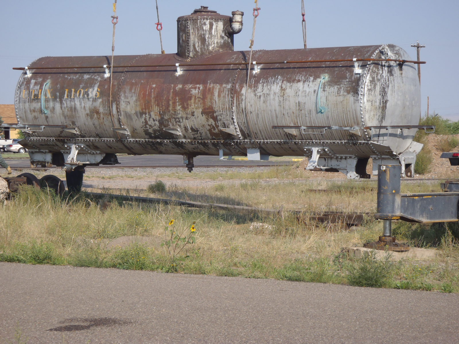

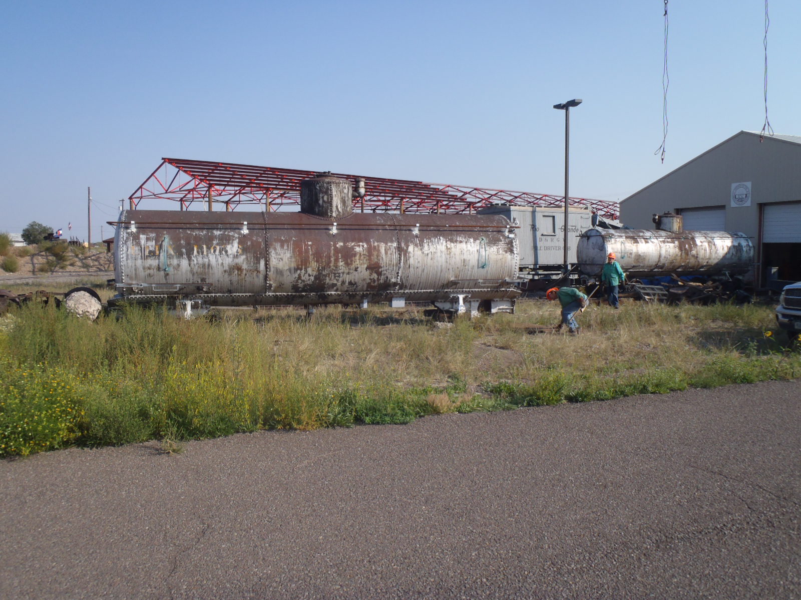

Team Leader Chris Trunk clears the area of debris so the crane can move forward to begin lifting the second frameless tank onto its trucks
First frameless tank car has been set on its trucks! Yea!

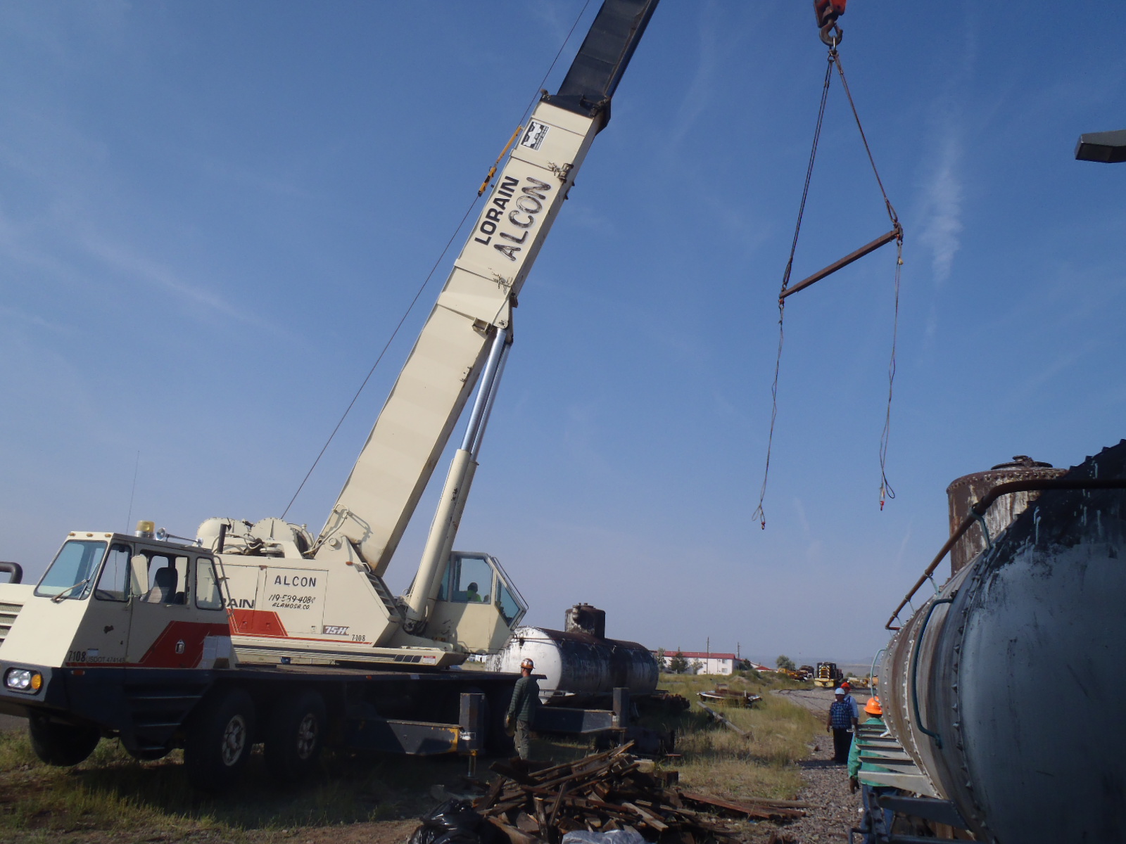

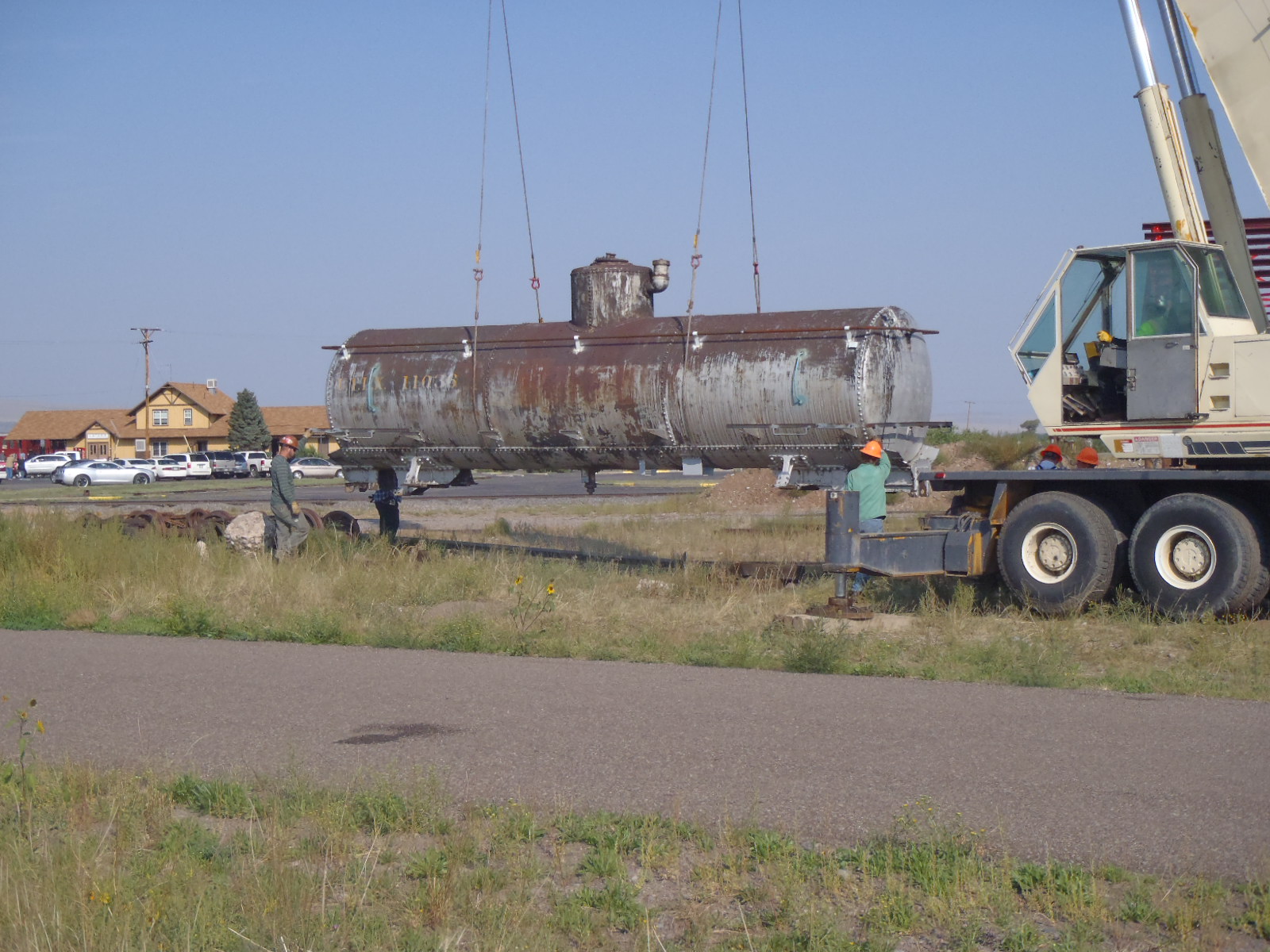

Crane operator moves cables into position to initiate lifting of tank car
Frameless tank car lifted off the ground - no problem!

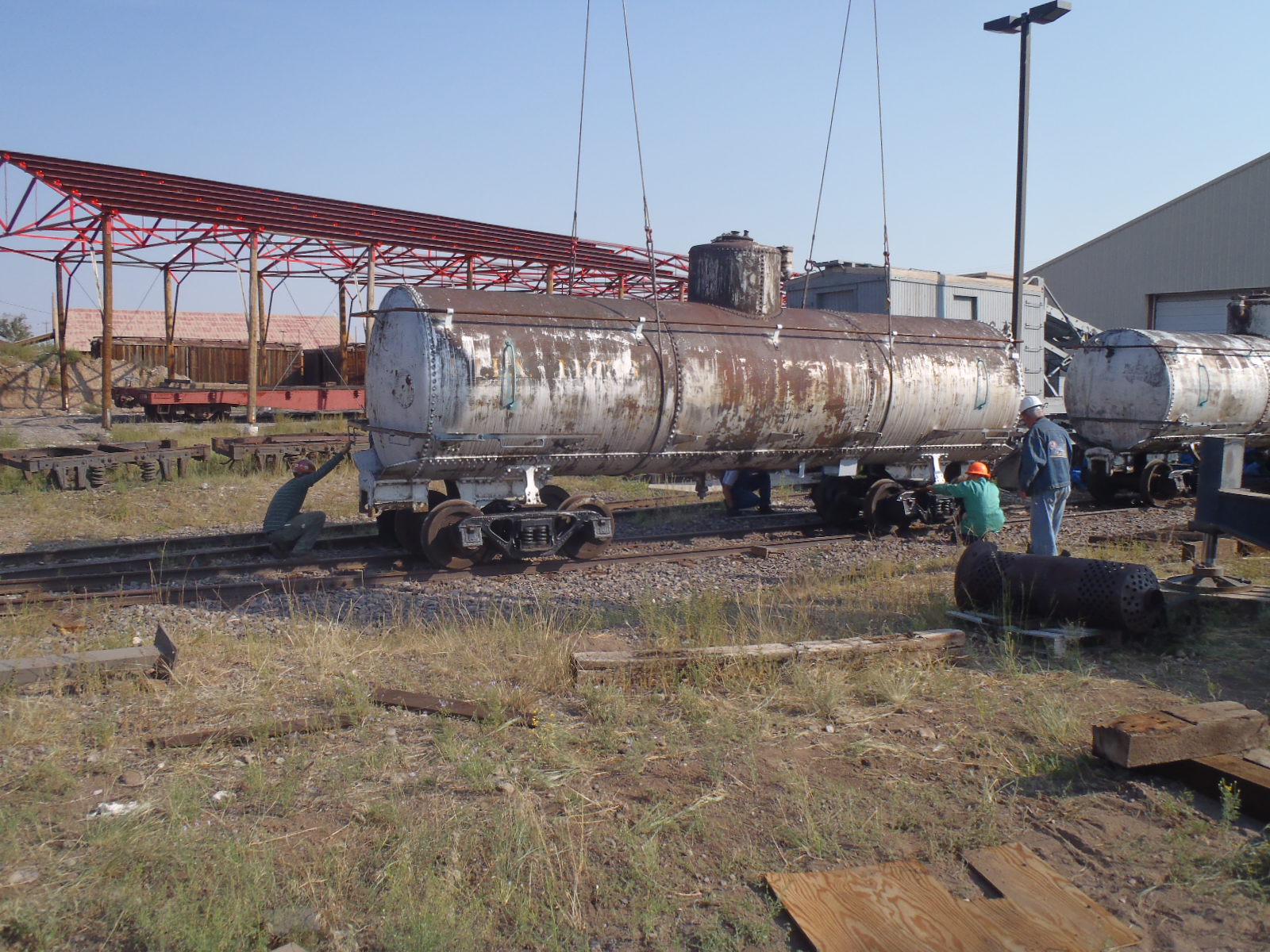

The crane operator starts the swing over the trucks

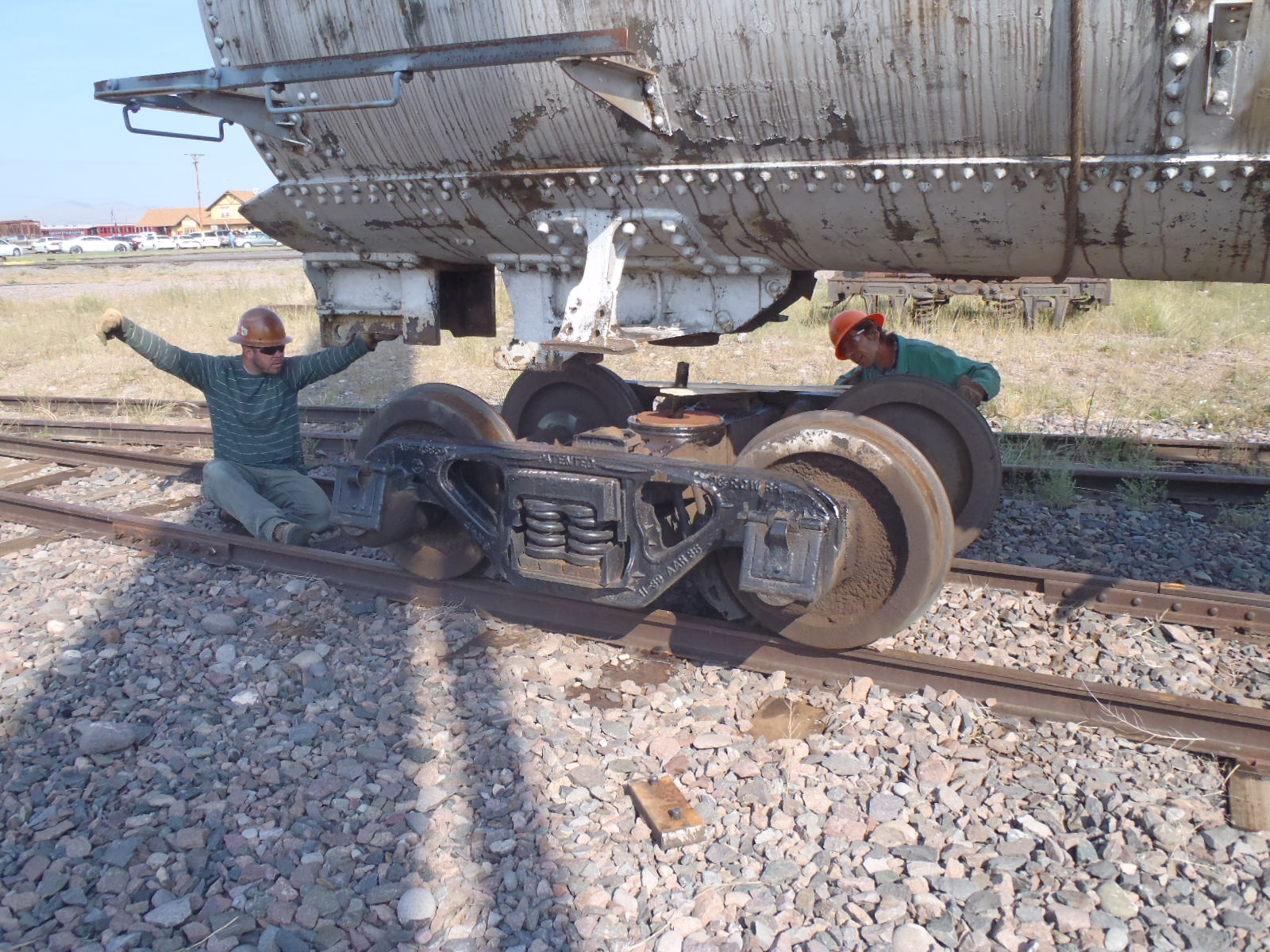

Frameless tank is lowered to check for proper clearance

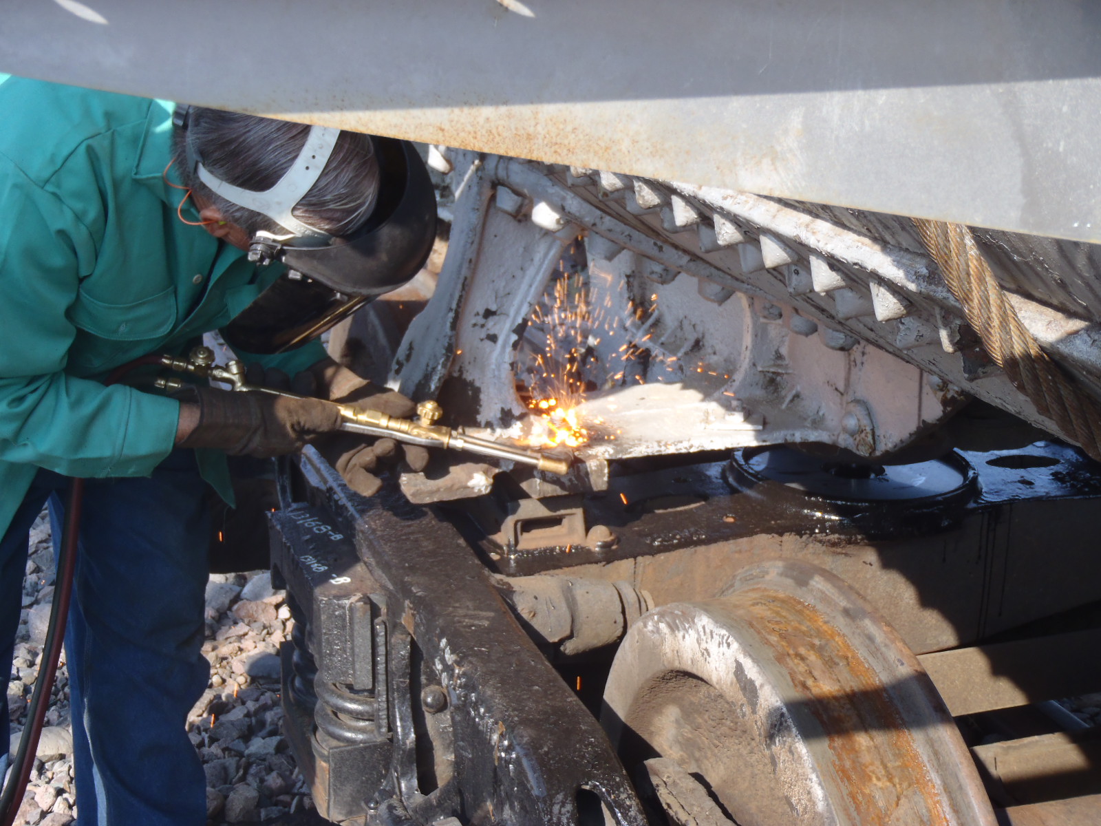

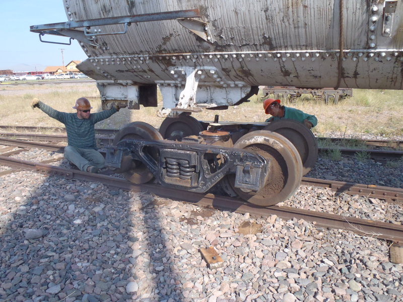

Frameless tank is lifted - clearance is not correct. Chris Trunk identifies the four spacers needed to be removed for proper clearance
Hardy Cruse cuts the spacer bolts with a torch
Crane company employee gives directions to crane operator as Chris Trunk places bolster pin into position

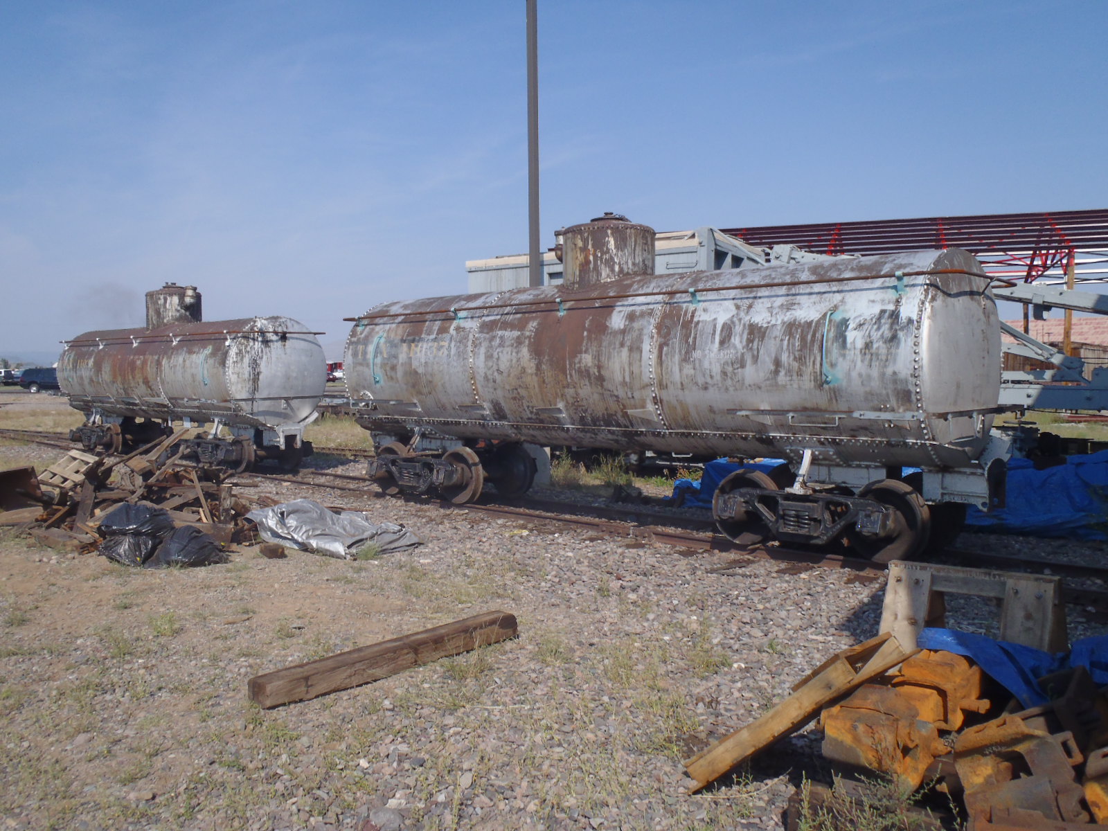

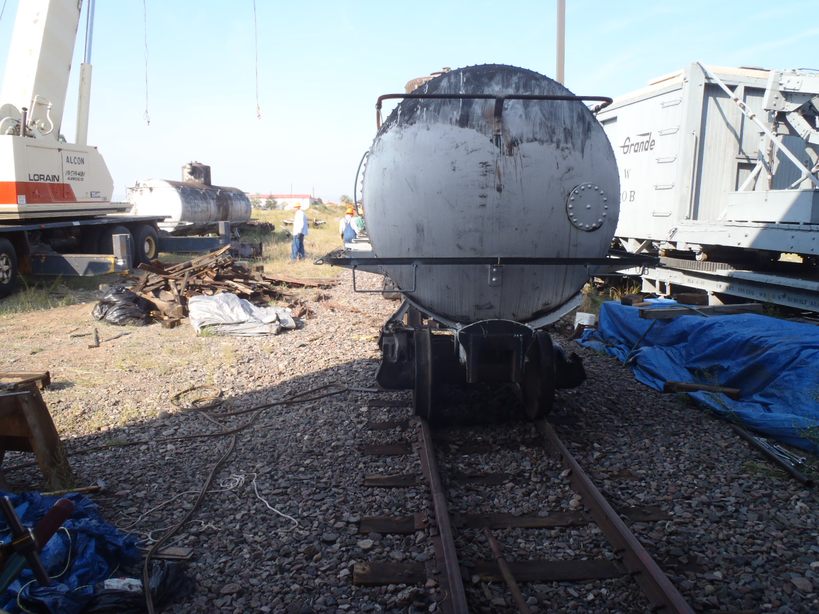

Both frameless tank cars are back on the rails where they belong; however, there's plenty of work left on both cars!
