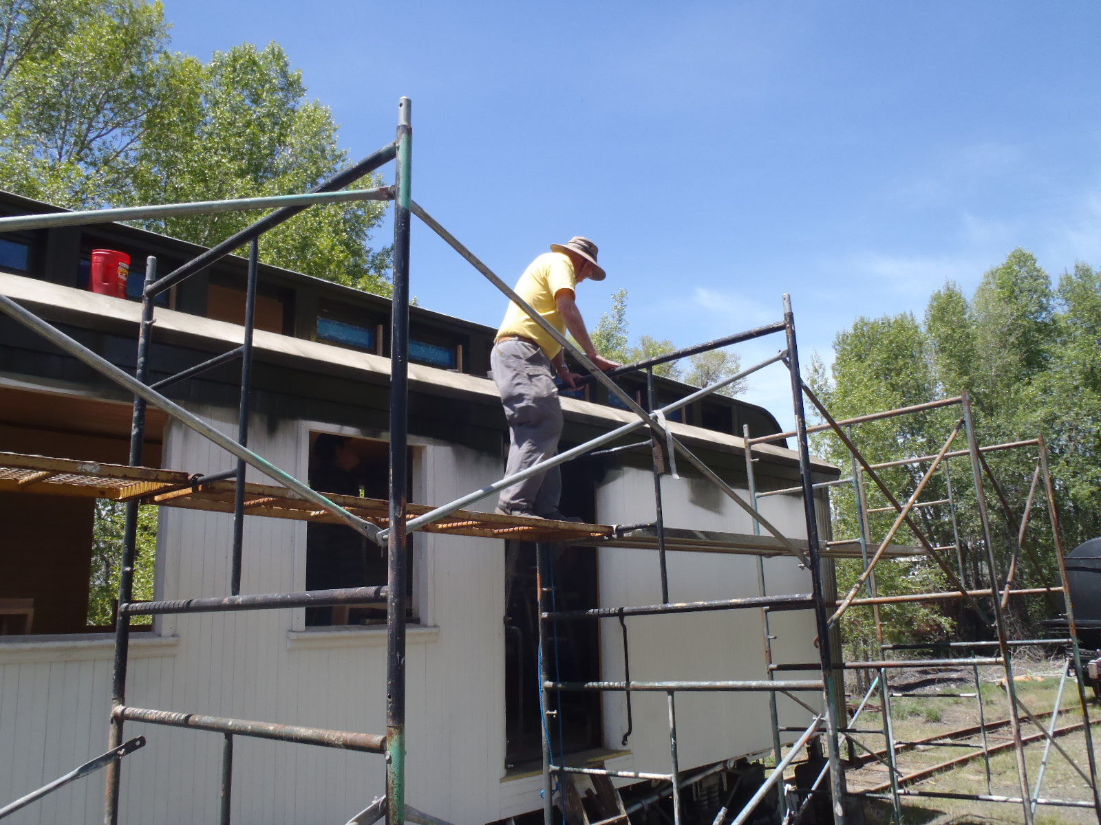

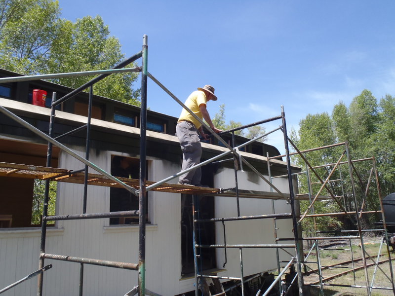

RPO 054 Restoration Team Leader Don Bayer works on a clerestory window

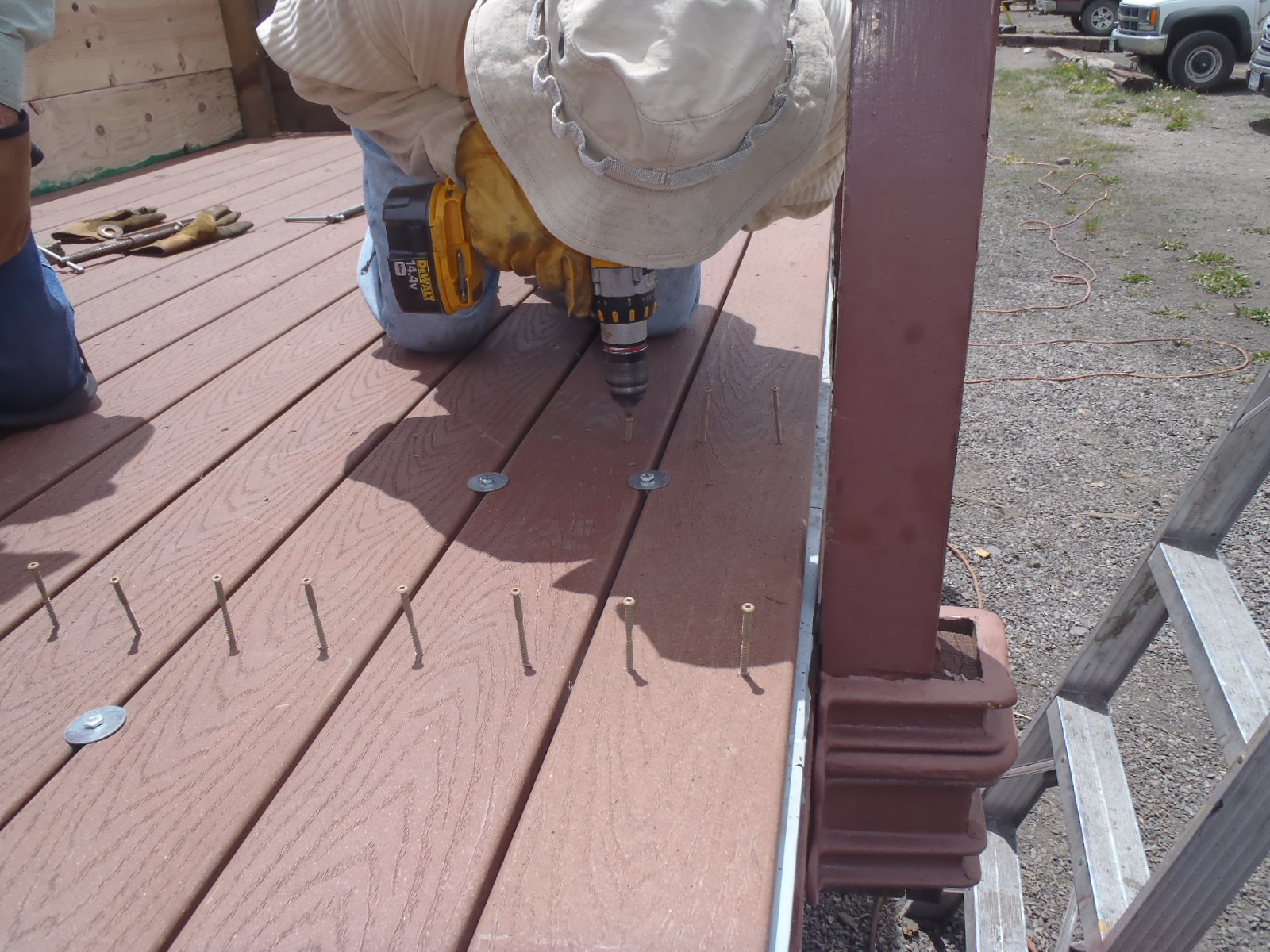

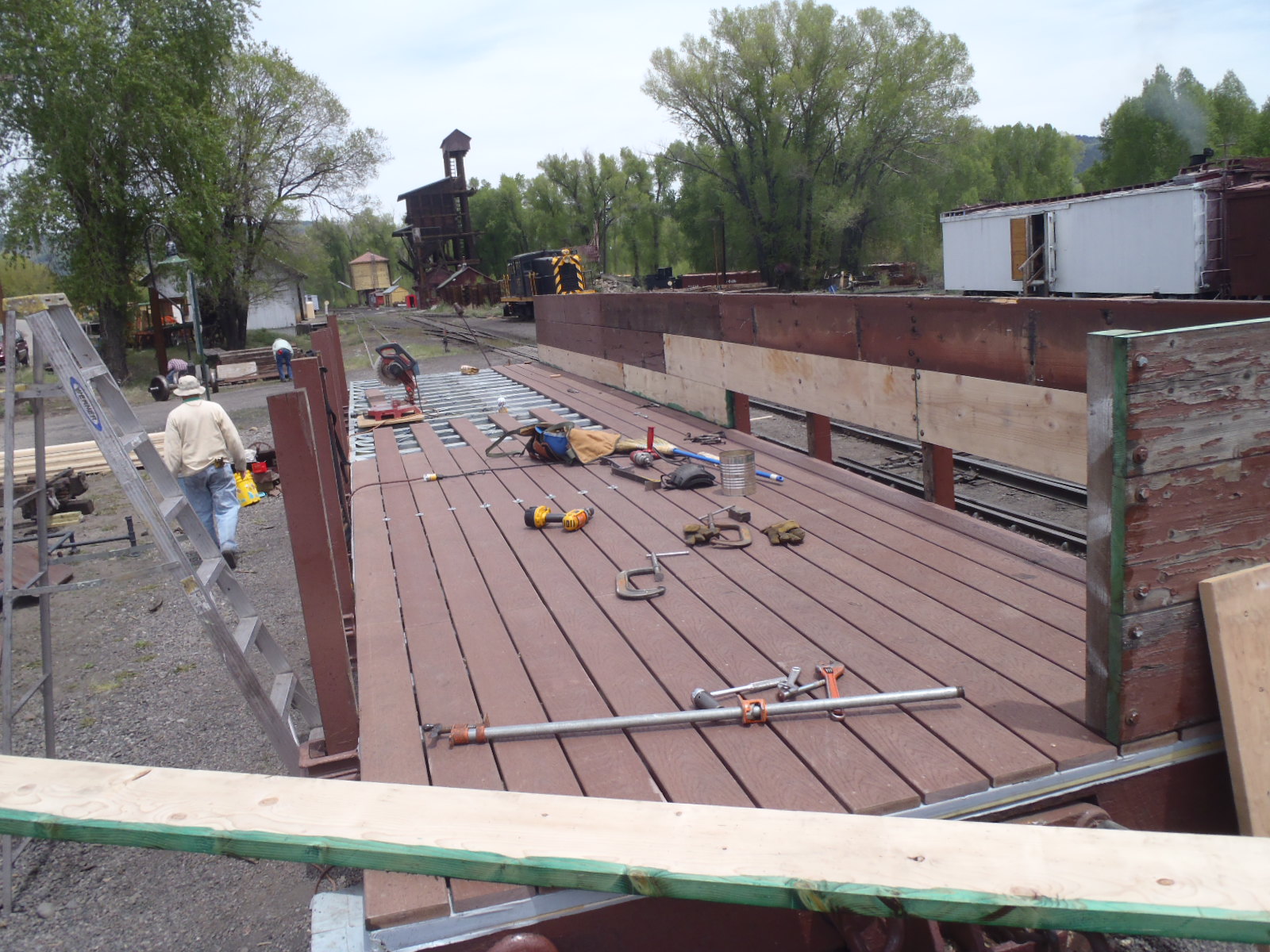

Good progress is being made on the "Cinder Bear" rider gon. The "Trex" flooring is going down along with new 2 x 12's o the sides. The bottom new pieces had to be cut down to about 2 x 10 size because of the 2 x 4's that were added to the bottom of the floor.
George Trever screws the "Trex" flooring to the 2 x 4's below The bolts with washers are used as temporary spacers to allow spacing for moisture draining, rain, snow, etc.

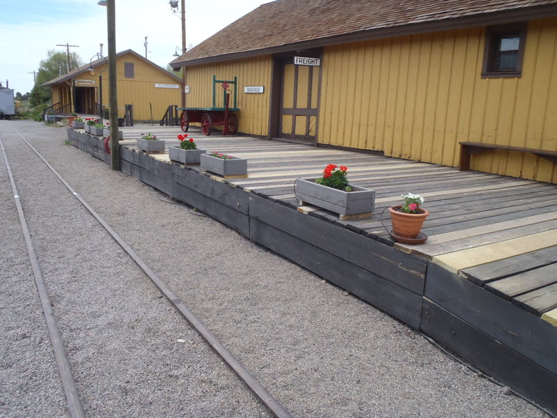

Dona Kazmar has planted new flowers in the planters on the east side of the Chama Depot

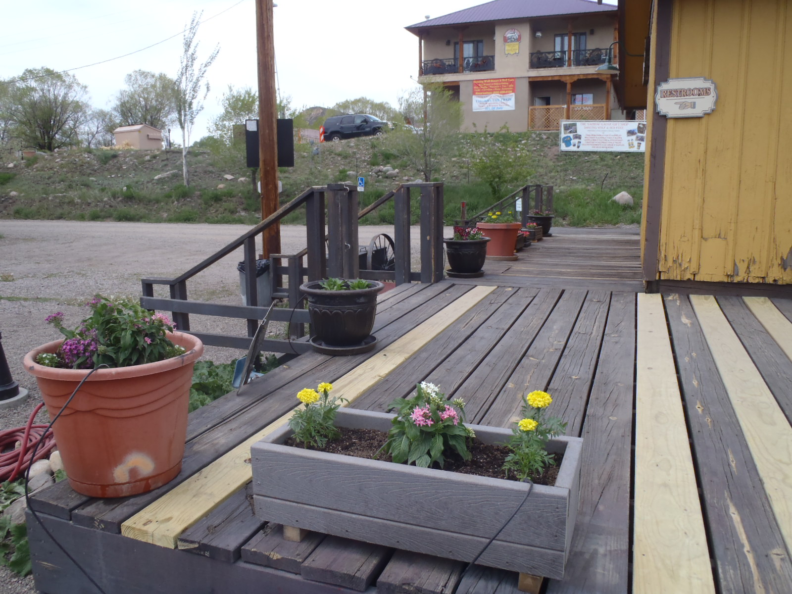

More new flowers in the planters on the south side of the Chama Depot. Thanks, Dona!

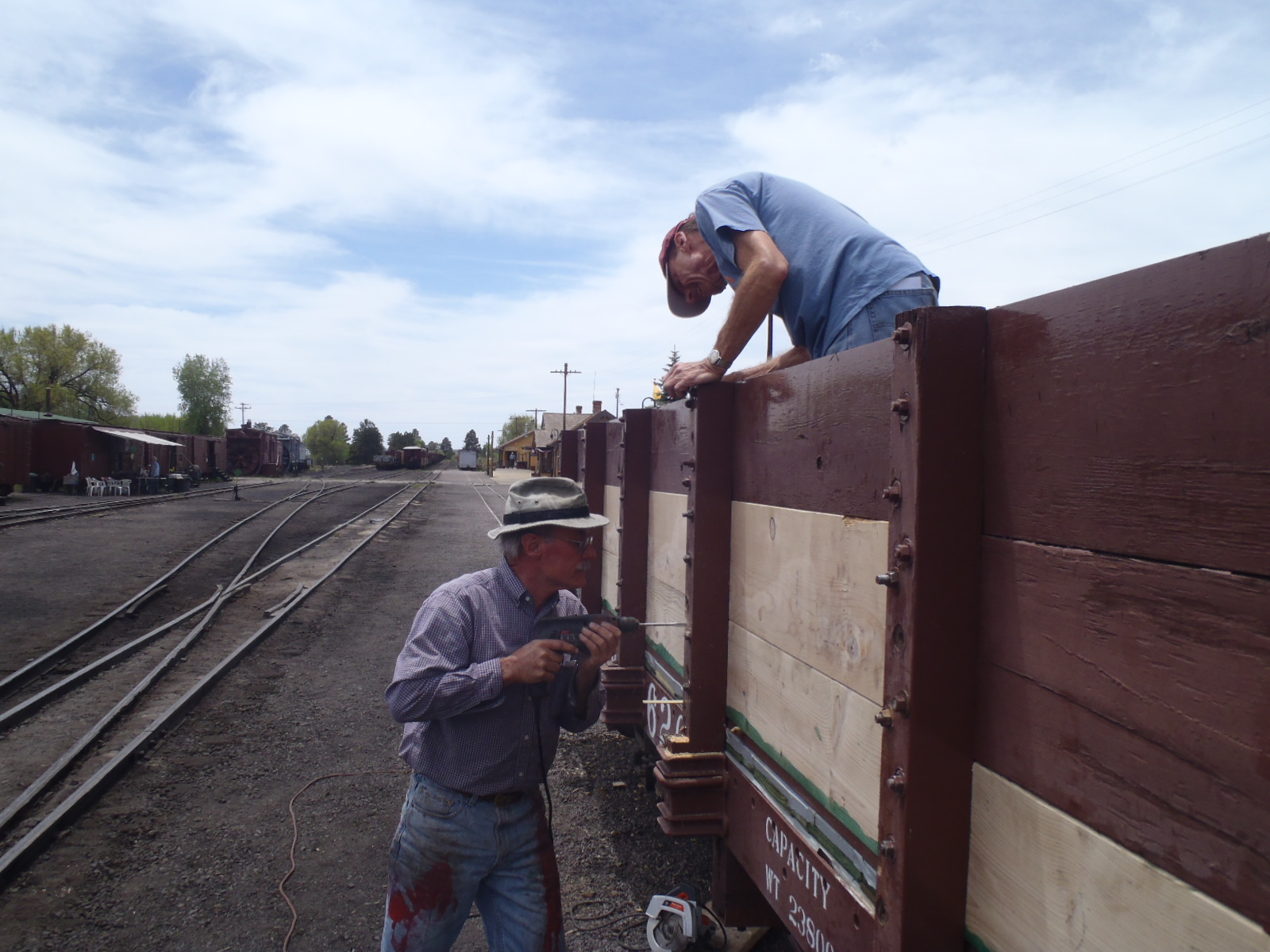

Team Leader Tim Bristow drills a new hole to bolt a new 2 x 12 to the side of the rider gon. Ted Kazmar is working with Tim on the inside of the car.

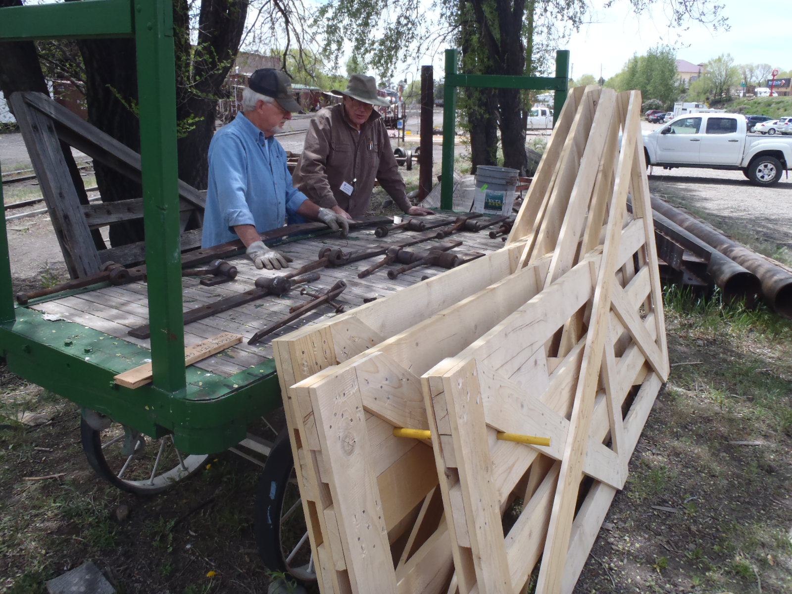

Carpenter Shop Team Leader Len Jones and Marshall Smith discuss needed repairs to the "heavy duty" hinges for the three new gates built by Len for the stock pens. Working alone, Len spent a day on each gate. They will be installed at a later 2013 work session.
