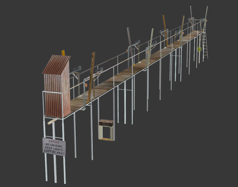

Russ, Several years ago I made 3D images of the major Chama structures. Each of them required a lot of research and a bit of intrepretation of photos. While my original notes are buried somewhere in my files the measurements can still be accessed with the program. If you need any info, I'll be glad to get it for you. The attached photo is from a screen shot of the oil dock.

Postby Russ Wood » Sat Feb 11, 2012 12:10 pm
Wow that 3d shot is just terrific!
One quickie! In the pix from the Friends site the sign is dark with white lettering, the current pix are white background with dark lettering. Question when and why the change? Thanks. Russ
