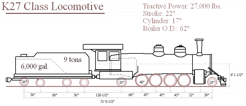

Fred, a Friend's member emailed this to me to forward to you.
K27 Plans:
http://www.bachmanntrains.com/home-usa/ ... /83093.pdf
Re: K27 locos
Unread postby Fred Bailey » Thu Jan 28, 2016 3:18 pm
Hello again,
Unfortunately the Bachmann link is for an electric model, I was looking for drawings of the original 1903 built locomotives and I am actively following up the previous suggestions at this time, but thanks for trying.
Fred

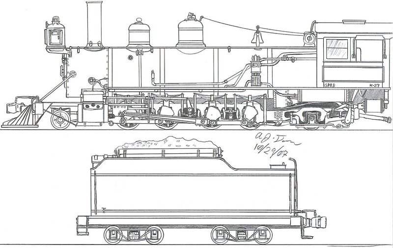

Re: K27 locos
Unread postby Jonathan Cordova » Sat Feb 06, 2016 11:21 pm
here u go
Jonathan Cordova
Posts: 376
