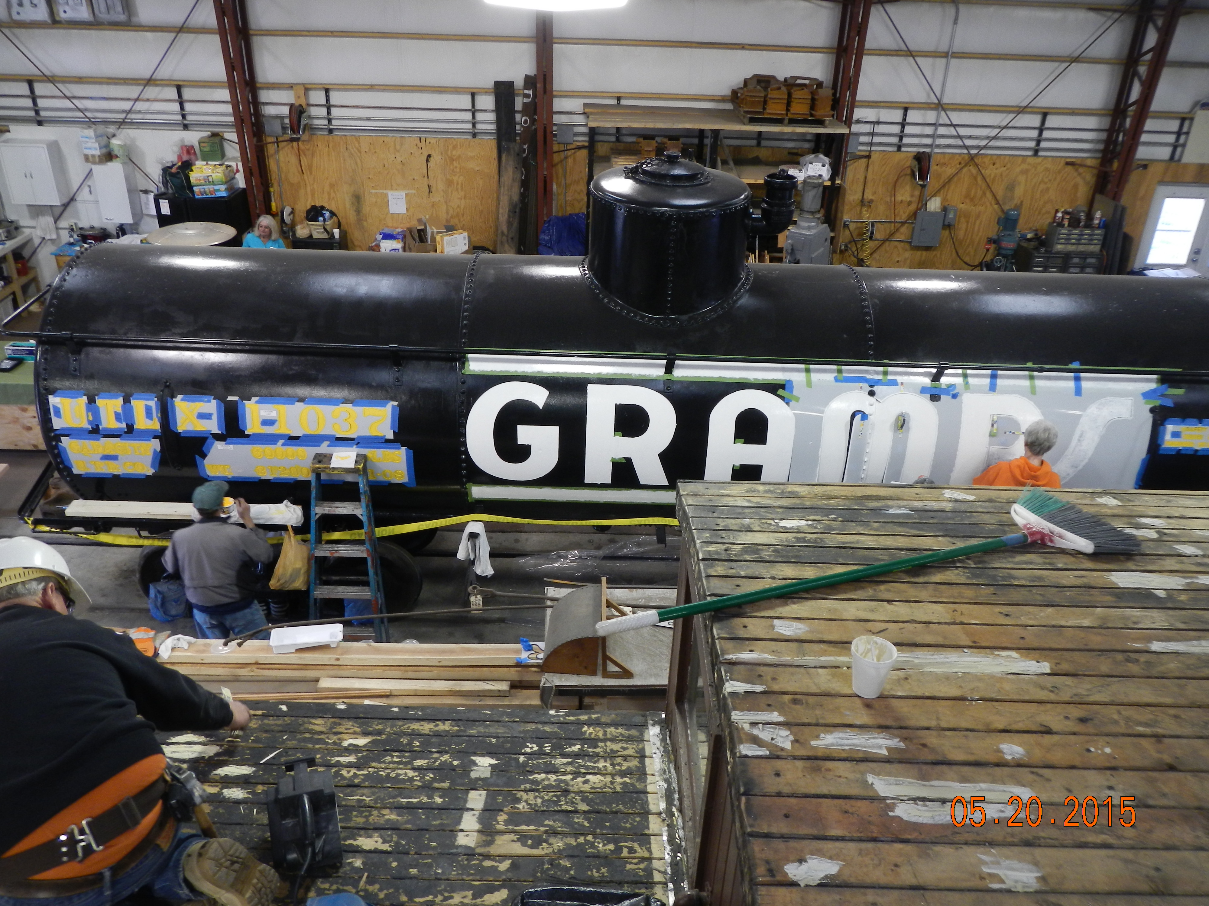

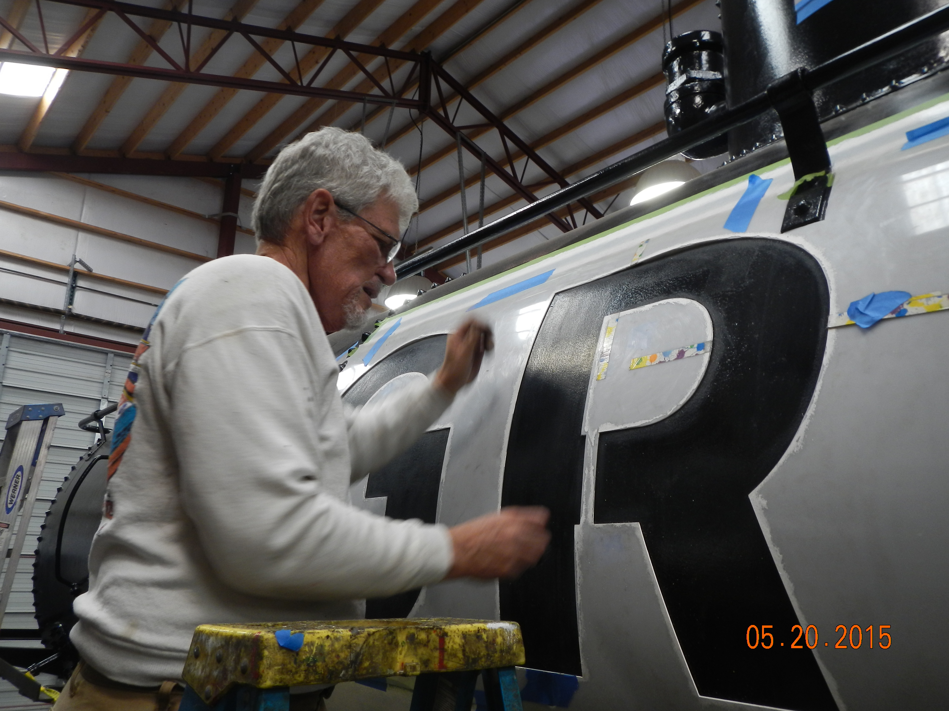

Two tank cars located in Antonito were painted with the highly specialized ACROLON multipart paint - usually a marine finish. The surface is so hard that if any over paint is to be applied after a period of 60 days the surface must be abraded - in this case using #3 steel wool - E3VERYWHERE any paint is expected to be placed and wanted to stay! Here a team member is scraping within the new stencils. Hard work.
The Gramps stencil was so large it was made in two parts - on the left are just a few of the many reporting marks many in yellow. Again every letter painted had first to have the black surface abraded, then primed with white paint so the final yellow paint would have its true color

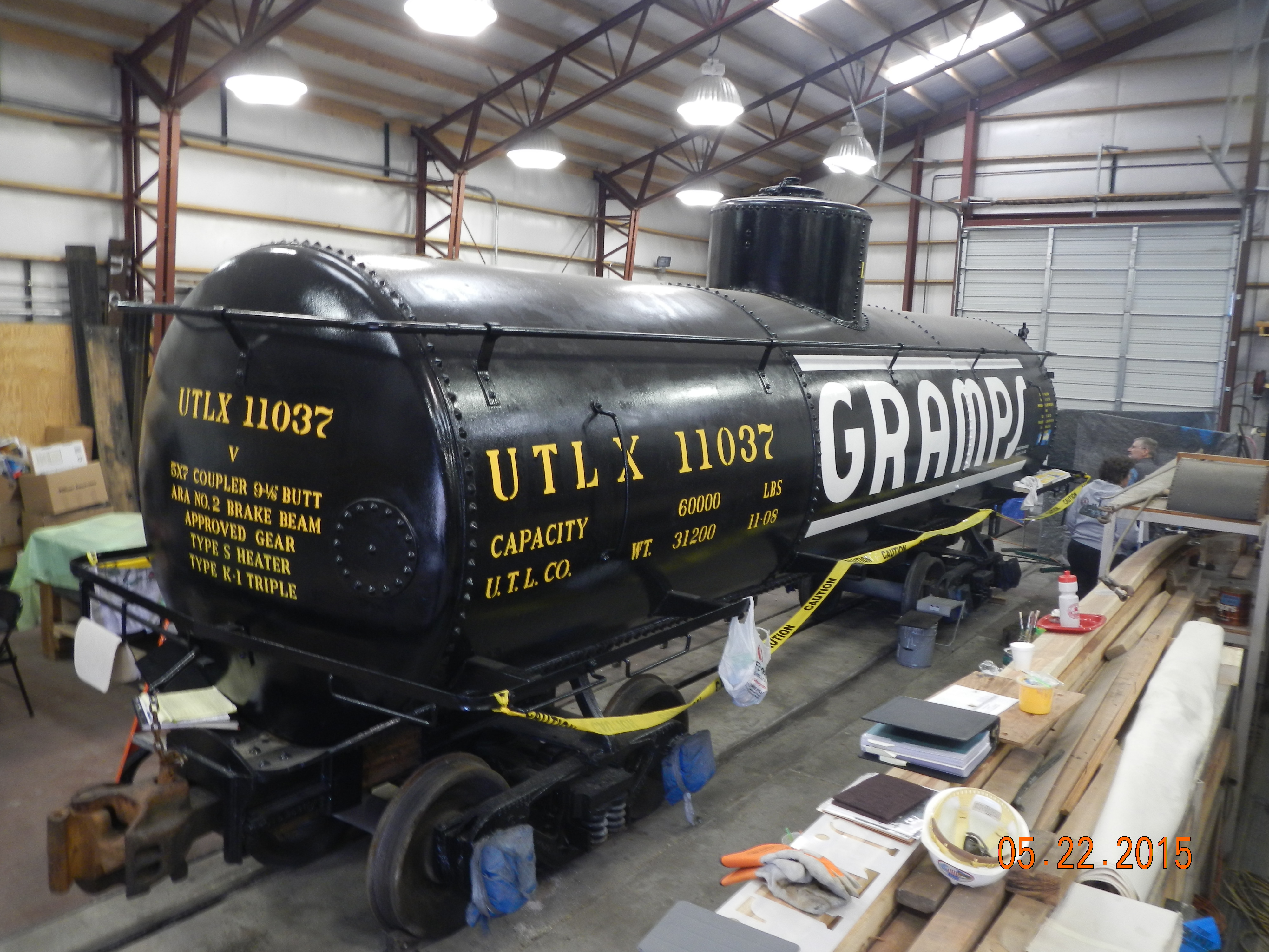

The car stenciling was more complicated than any other car ever done by a Friends crew - 4 people working hard 5 days and it is not quite finished. Tem leader Valley Lowrance has some final touchup to do on Monday of Work session B.

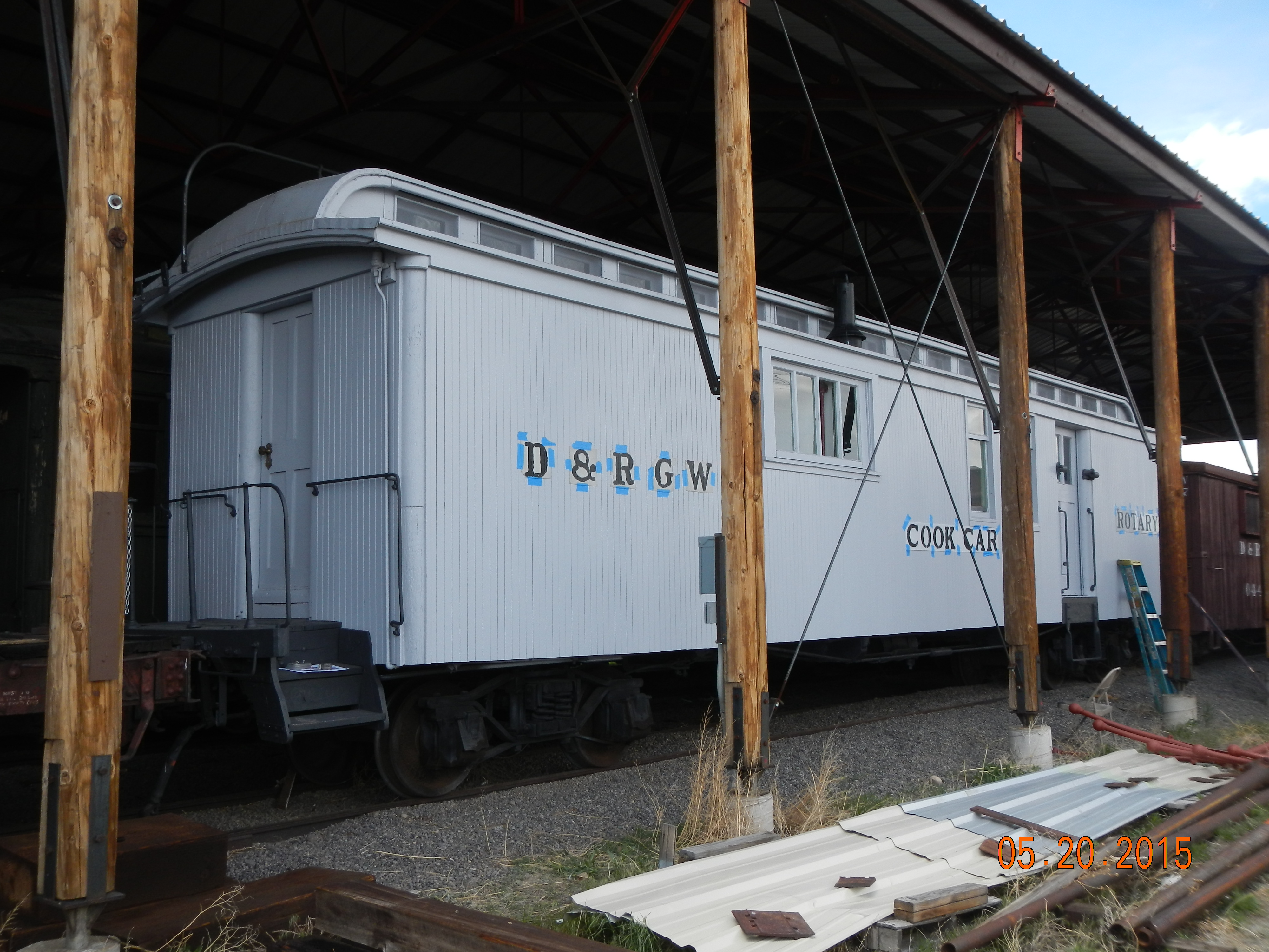

The stenciling team even found time to prepare and stencil one side of cook car 053

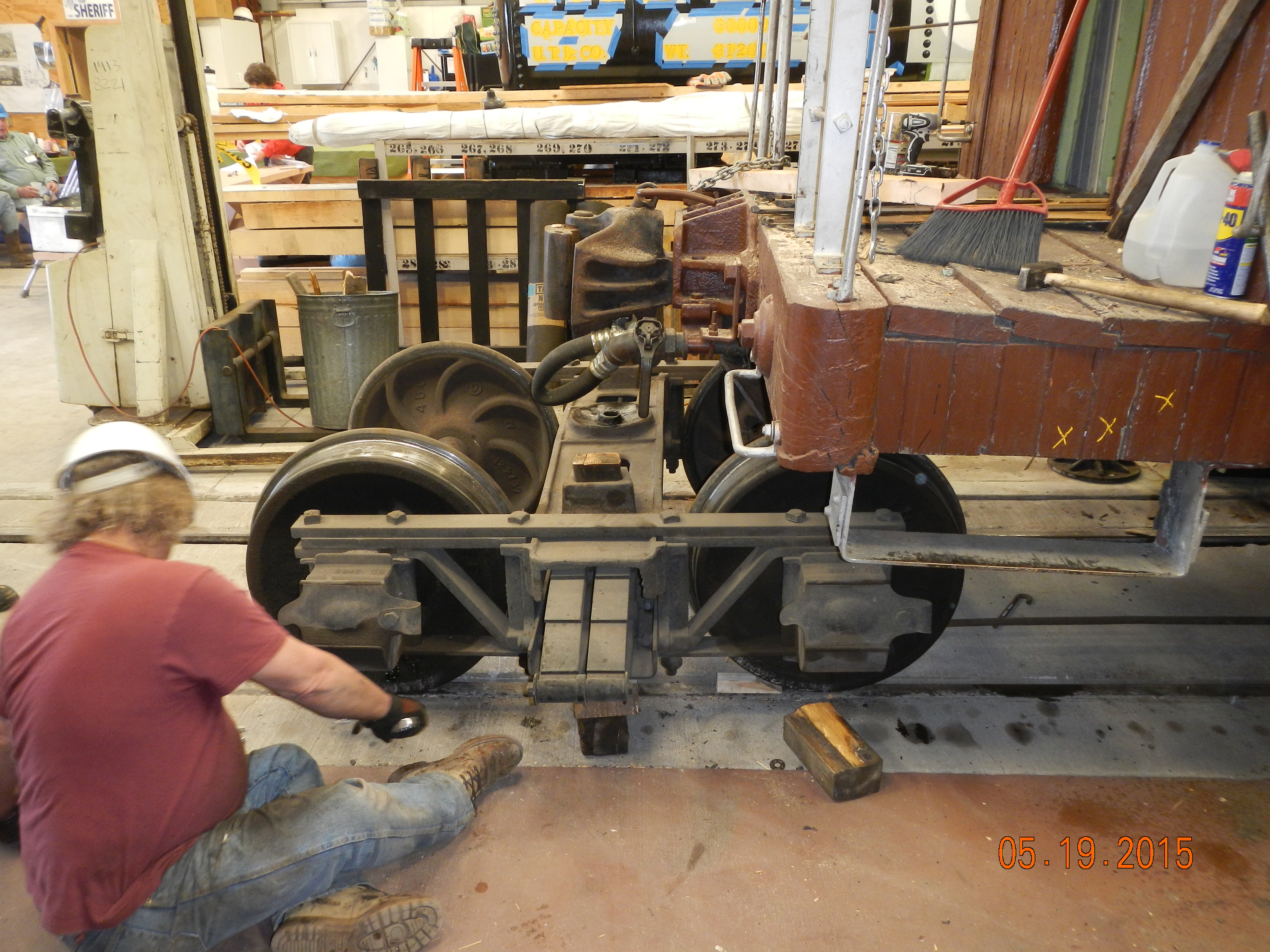

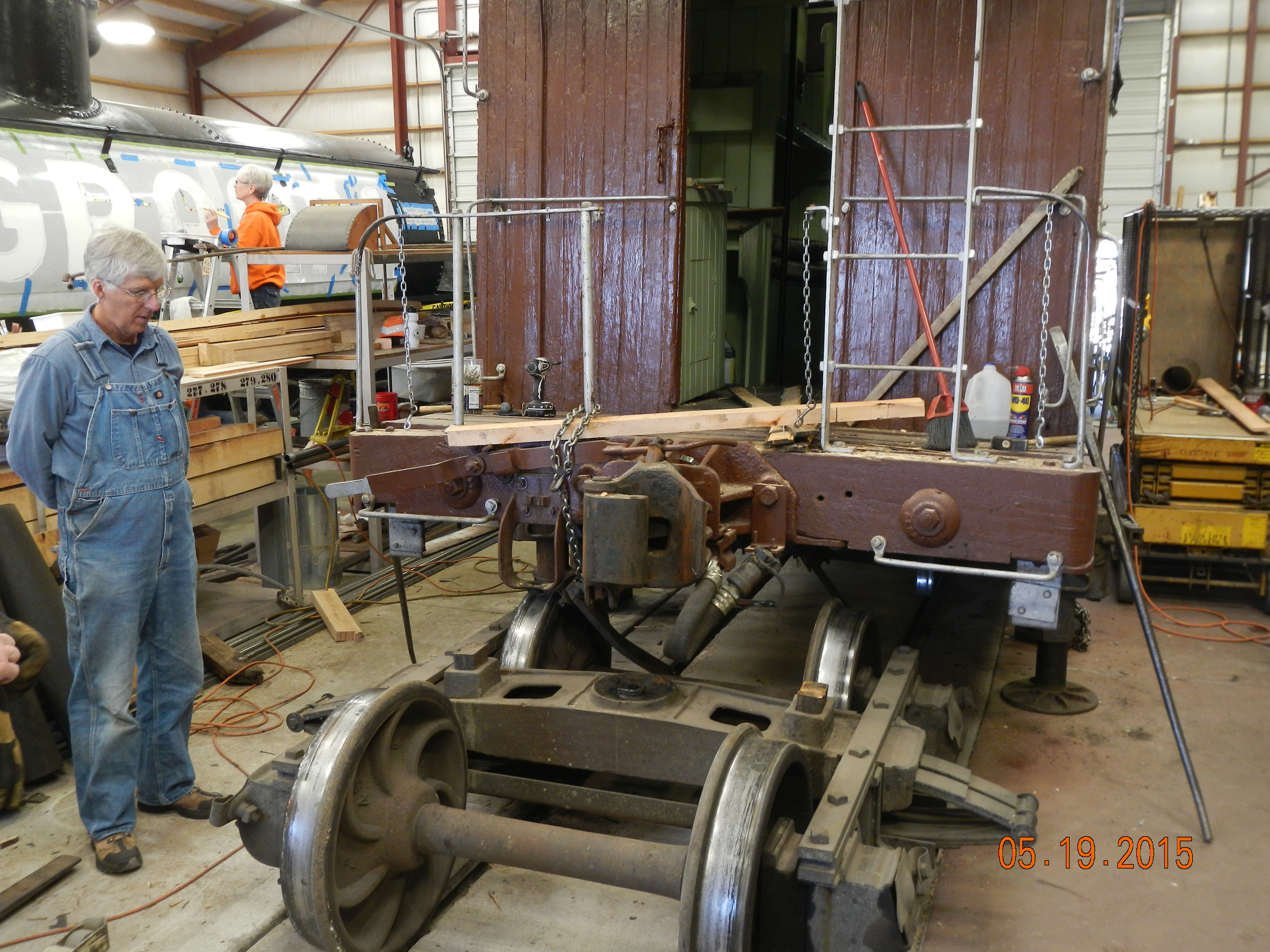

Housed on CRF track 4 is Caboose 0579 - in for extensive work. Roof leaks had damaged several windows and the framing below them. You saw the partially repaired roof in a side shot of the GRAMPS tank car earlier. Also a wheel set was damaged and needed replacement - the work was hard and dirty but went well.

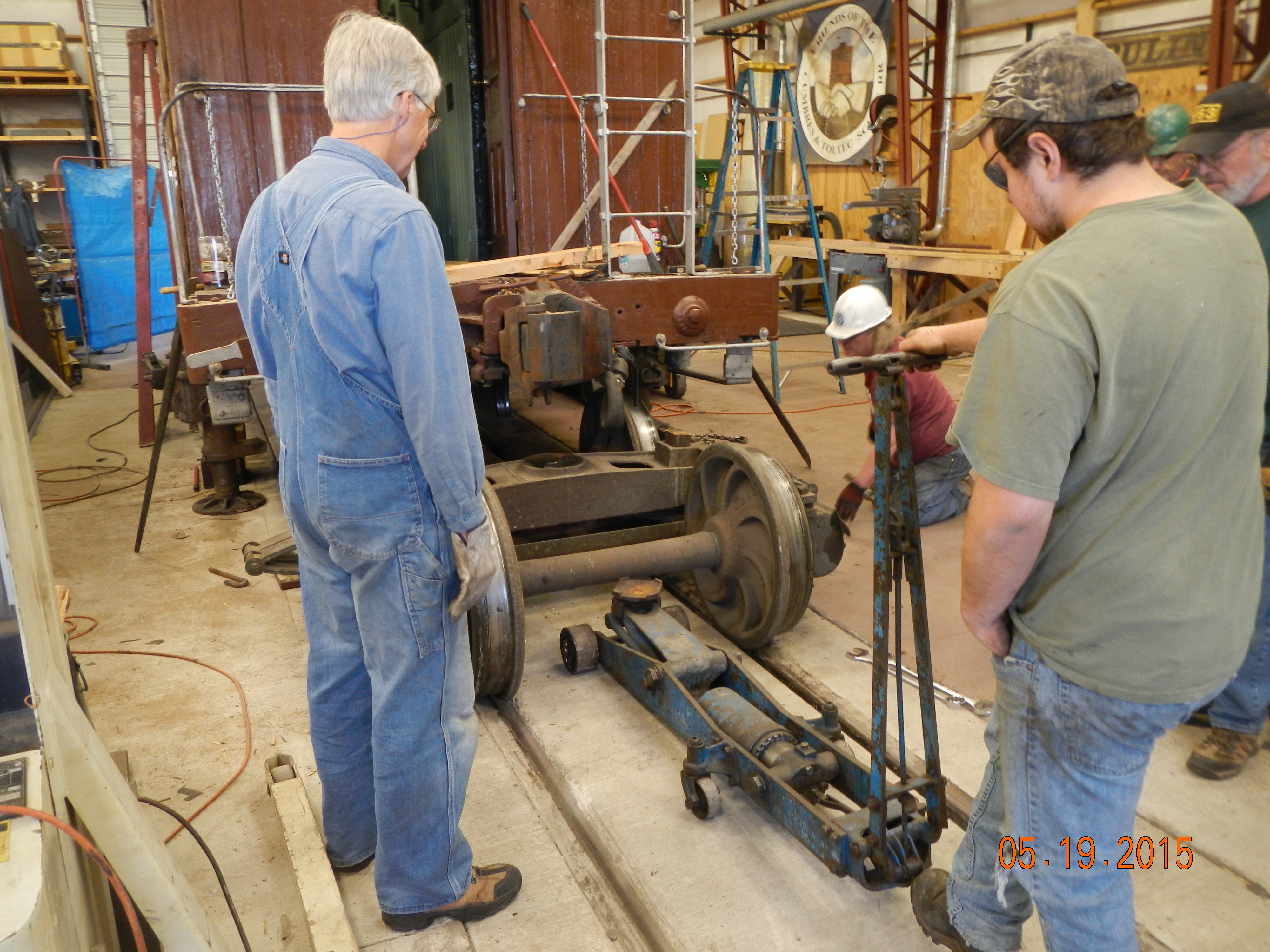

Another view of the truck replacement work

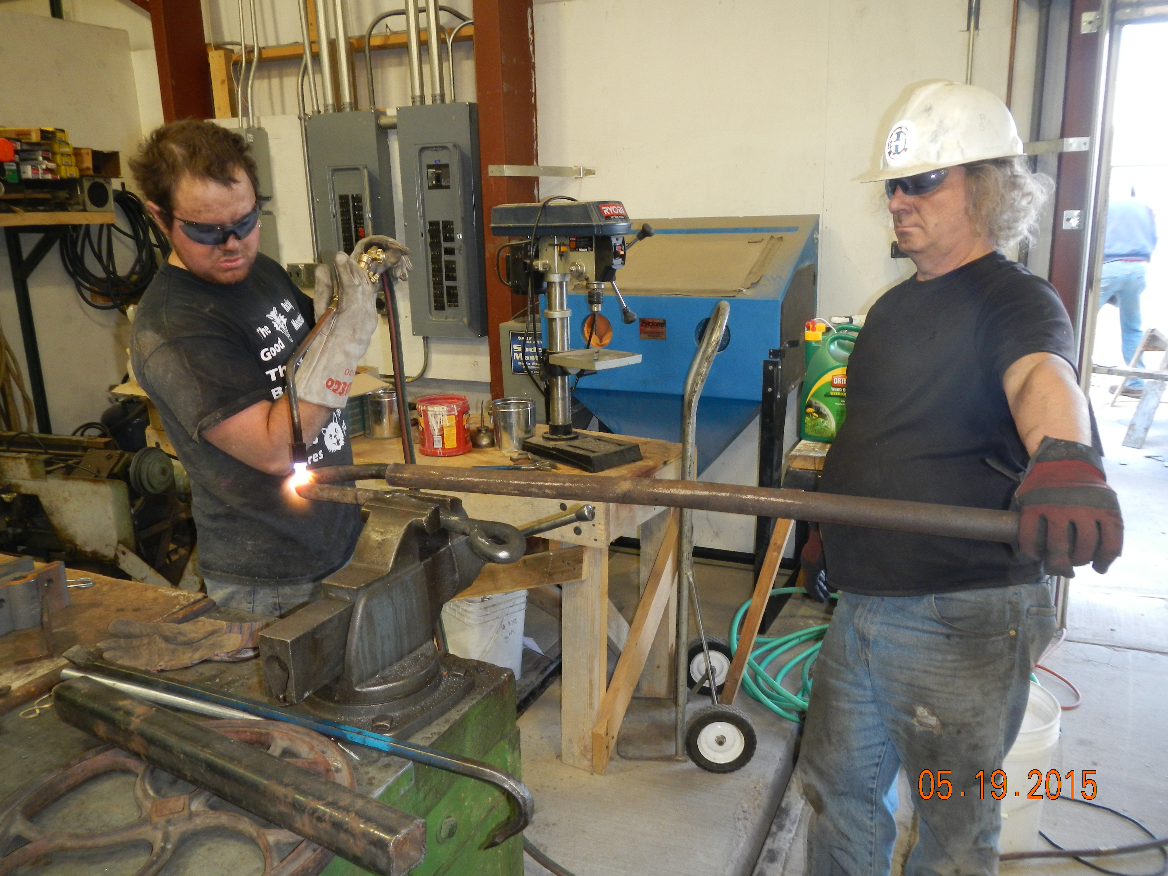

Acting on a Marvin request the brake rigging is getting a bit of reshaping - Neat Father and Son!

Excellent job! Pretty sweet! That car sure provides the WOW factor now!!!!

A great job Cris and crew and the stenciling team!

YES! Valley Lowrance and her stenciling team REALLY outdid themselves on that job, now how are they gonna top that one? ;-)
