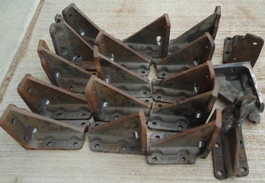

2 - Completed angle brackets for 053 trucks (16 in all) - Russ Hanscon, Farmington, NM.jpg
Completed angle brackets for Cook Car 053 trucks (16 in all) - Russ Hanscom, Farmington, NM

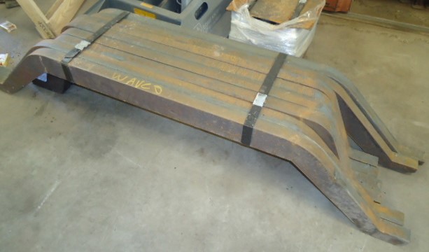

3 - Equalizer bars for 470 and 053.  These are laser-cut by an outside shop and still need finishing..jpg
3 - Equalizer bars for 470 and 053. These are laser-cut by an outside shop and still need finishing..jpg (41.03 KiB) Viewed 3857 times

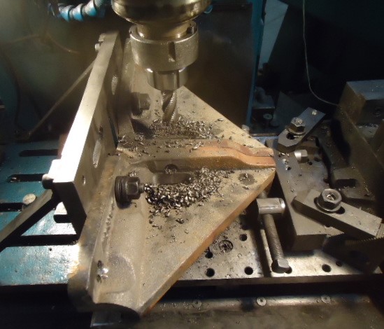

4 - Two-up setup for slotting angle brackets - 16 in all.  For 053 composite trucks..jpg
4 - Two-up setup for slotting angle brackets - 16 in all. For 053 composite trucks..jpg (65.82 KiB) Viewed 3857 times

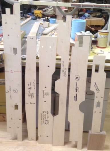

5 - 470 oak truck patterns - Craig McMullen, Colorado Springs, CO.jpg (75.41 KiB) Viewed 3857 times

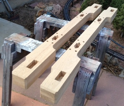

5 - Axle guard for Tourist Sleeper 470 - C. McMullen, CO.jpg (36.56 KiB) Viewed 3857 times

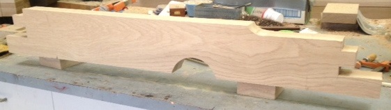

6 - Cross timber or transom, Tourist Sleeper 470 - C. McMullen, CO.jpg (53.53 KiB) Viewed 3857 times

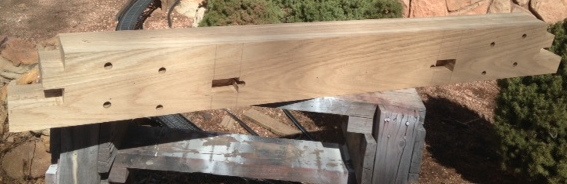

7 - End sills for Tourist Sleeper 470 - C. McMullen, CO.jpg (82.38 KiB) Viewed 3857 times

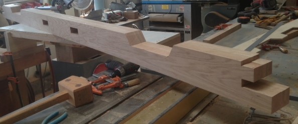

8 - Side sill or wheel piece for Tourist Sleeper 470 - C. McMullen, CO.jpg (35.93 KiB) Viewed 3857 times
