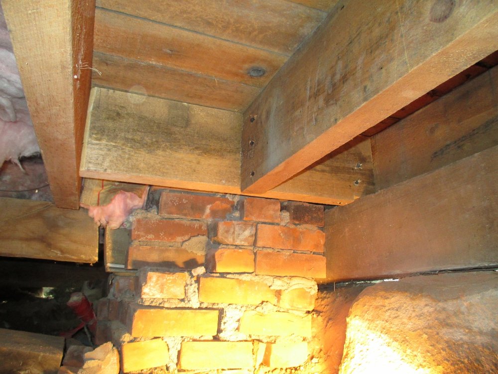

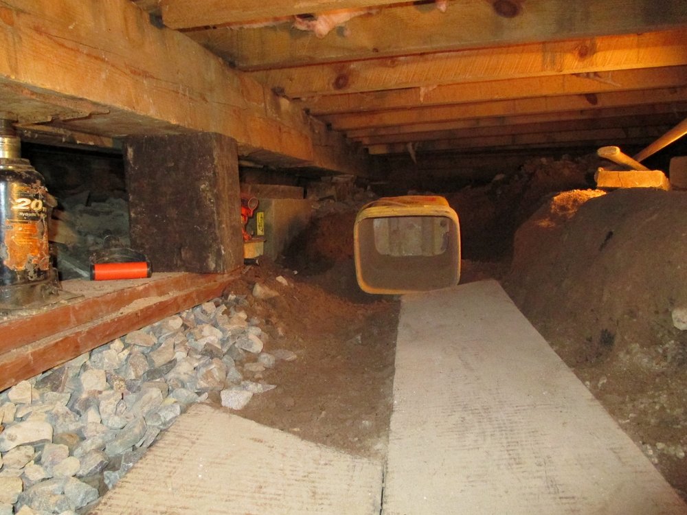

Bob Conry volunteered to continue work following Session-F on the Car Inspector's House and the Section House. He completed painting the new boards on the Inspector's house west side and the east side of the Section House. He and Ron Horejsi did a lot of digging under the sagging floor of the Section House to prepare the way for lifting the floor by the end of August. During inspections for the lift, Ron and Bob had to chip away at some brick and mortar about the chimney, both in the crawl space and in the attic. This material would have interfered with the lift. Preparations were completed on August 28 and the lift performed (see Kanocz's pictures). George Trever also assisted by making frequent measurements during the lift and relaying them to Bob, the cellar dweller. The lift was finished that afternoon with the NE and SE corners of the main Section House room only 1/4-inch higher than planned and a remaining 1/2-inch lower for the center (next to the chimney) point. The reference line was 48 1/2-inches in the main room using a laser reference beam. If the foundation can dry out by next spring, the a final adjustment can be completed. In the mean time, Bob will work on raising the porch and preparing the site for winter. Hopefully, the railroad can install a french drain between the tracks and the Section House before winter to help with the drying process.
Photo shows some of the preparation work about the fire place prior to lifting of the west section of the Section House.

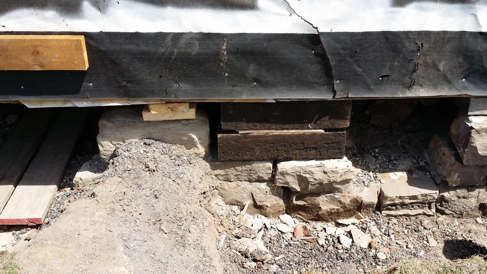

Photo shows the foundation (at the right) and main beam under which the heavy jacks were placed.

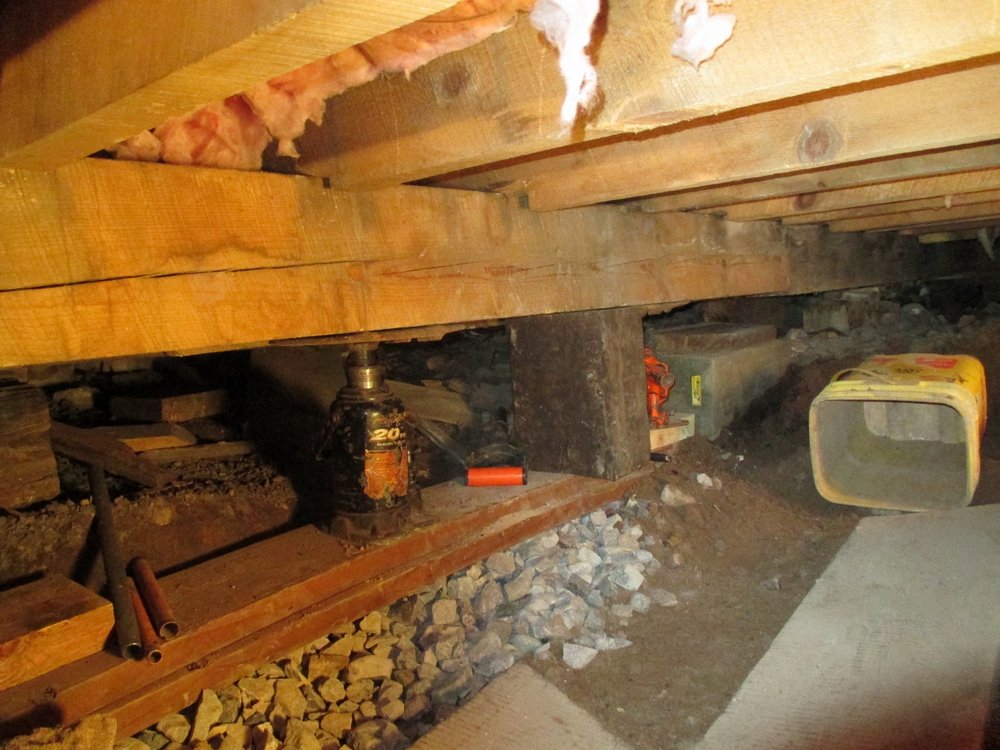

Here you can see the two jacks placed under the main structural beam.

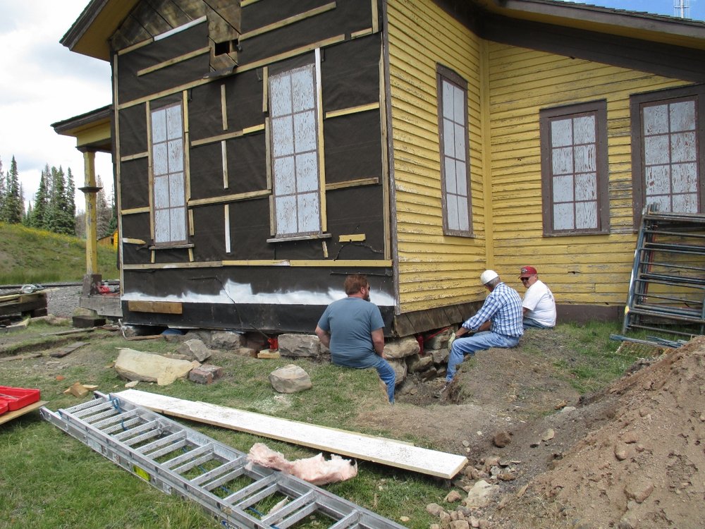

Photo shows the trench that Bob and Ron dug to get access to the lift points. Such fun it must have been.

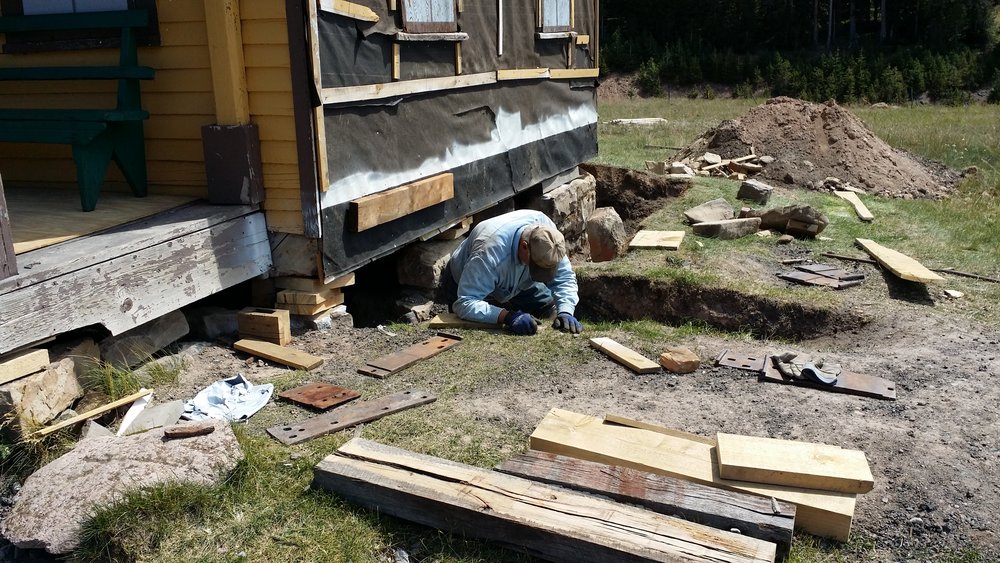

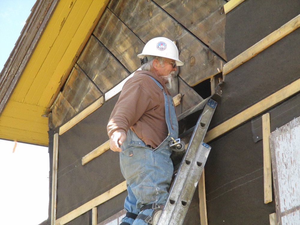

Bob Conry cuts into the west side of the Section House to access the fireplace in order to chip away mortar and brick that would have interfered with the lift.

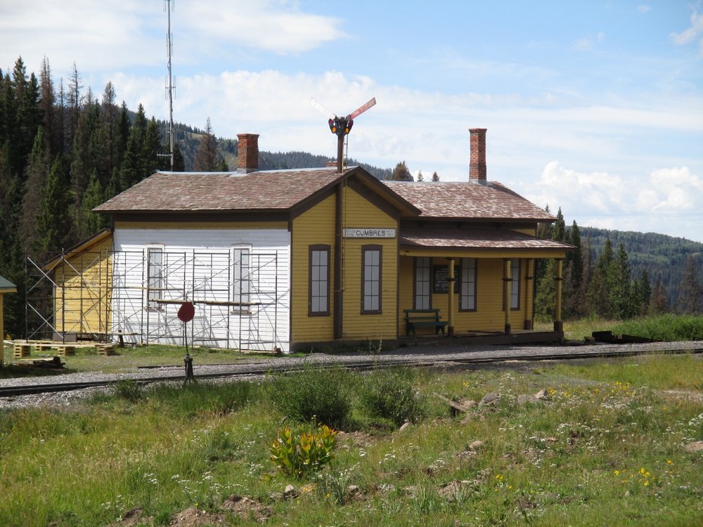

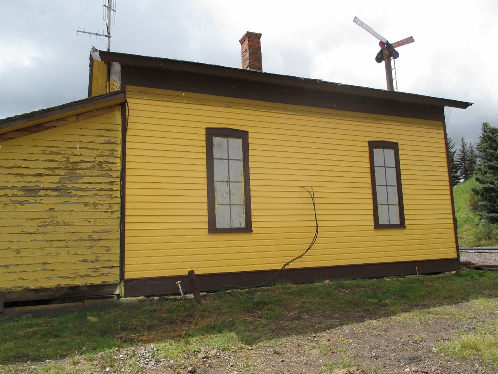

Photo shows the east side of the Section House after the siding was replaced with pre-primed boards.

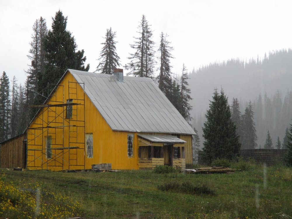

The Car Inspector's House received new boards and a paint job (how do you like that yellow?) by Bob Conry. Note that the photo was taken in the rain, a daily occurrence at the pass.

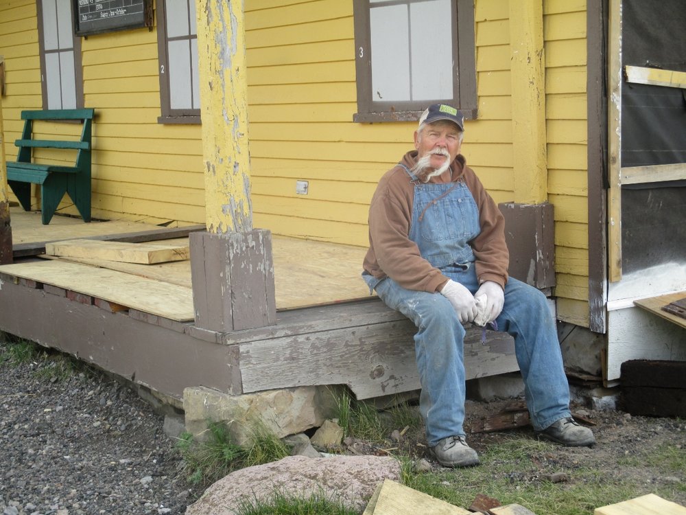

Here is Bob Conry taking a much needed rest at the Section House.

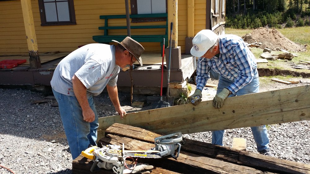

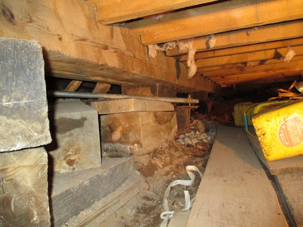

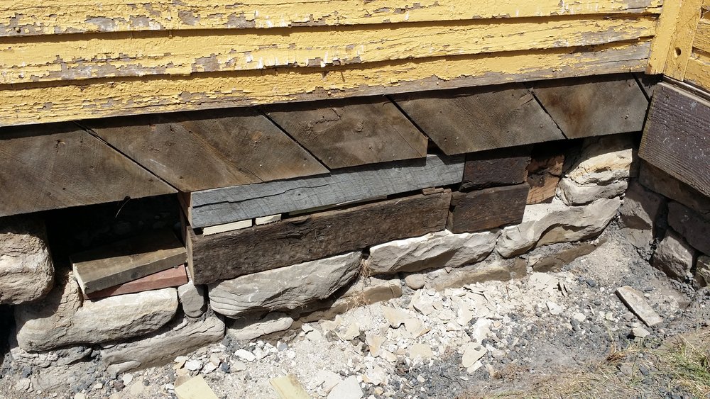

Here's a few photos of the cribbing that's supporting the section house. This is temporary until next year.
Geof and Bob were cutting shim and support today on Tuesday 9/2/14
Ron was briefly out from the crawl space. Bob was still under section house
It sure would be nice to get donations marked for a masonary stem wall for this area. Meaning additional donations like the tank car brass fund. Above and beyond our current fund raising for this work.
