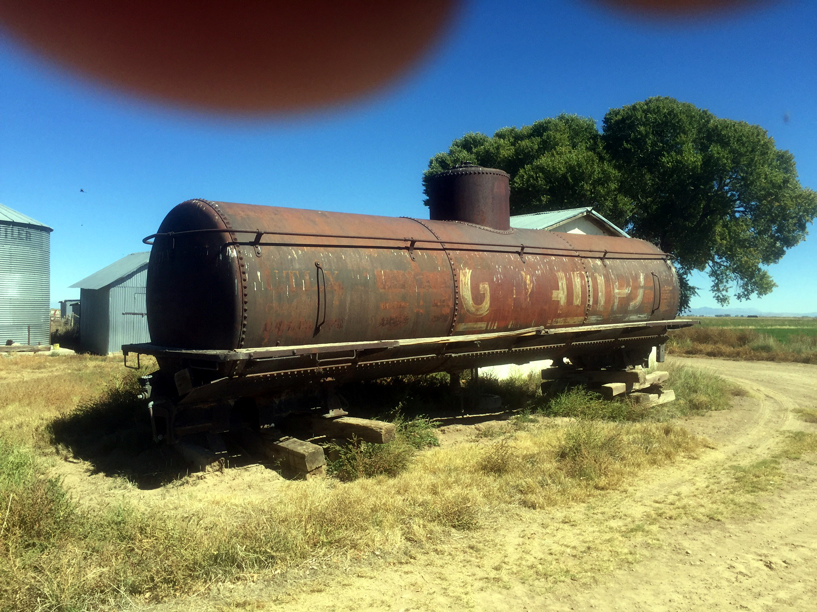

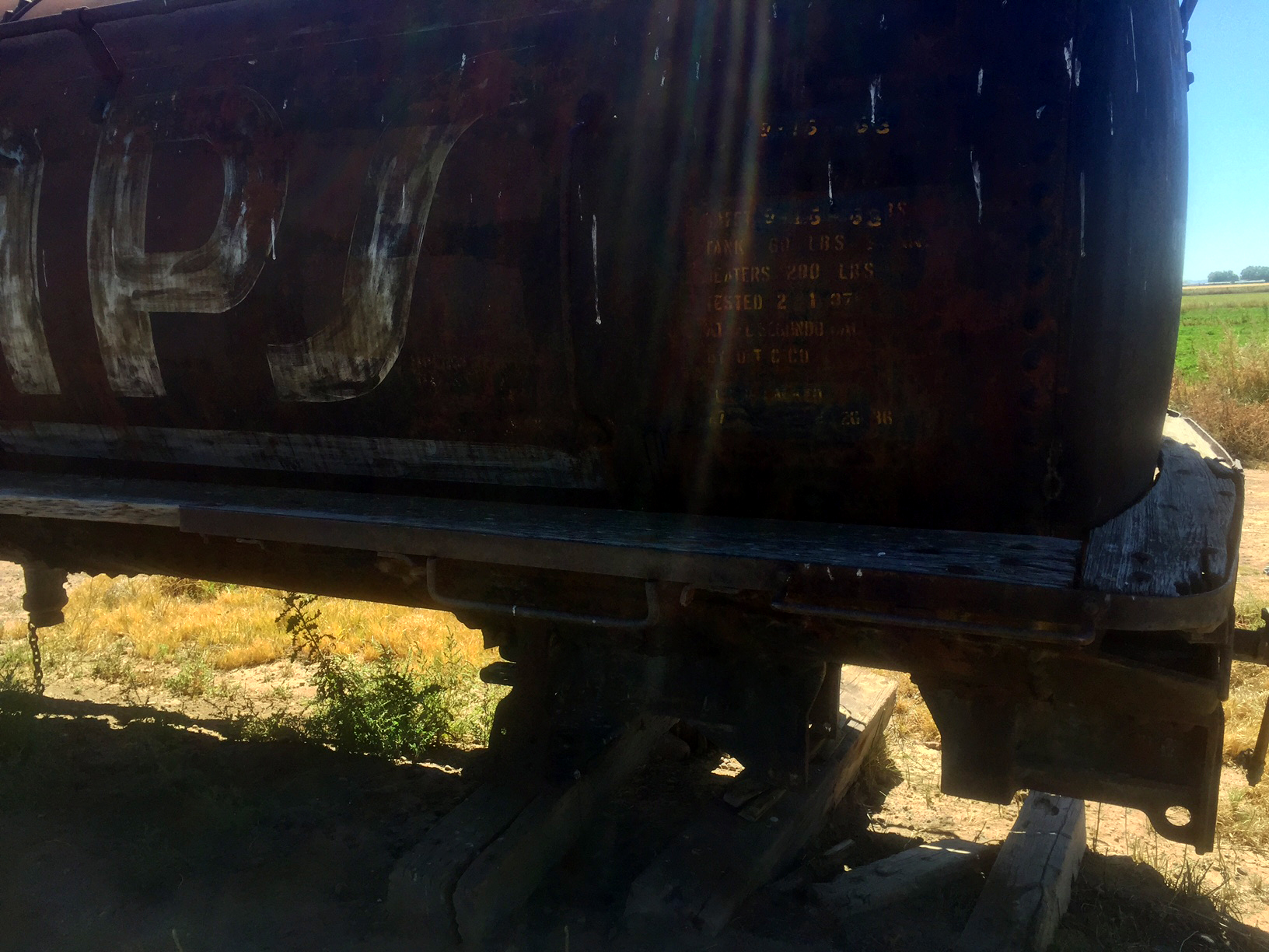

Thanks for posting my photos Jason, it appears you can see my fingertip in the first one. Oh well, at least you can see our new baby that should be on the railroad by session B this May. Dan has been working on getting this car for years, and it is hard to believe it finally is happening.

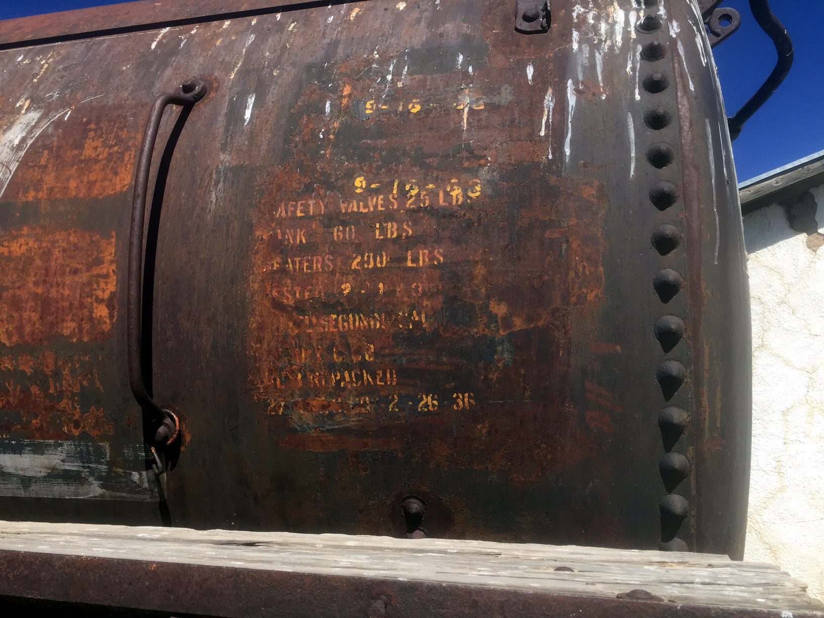

If you look closely at the 7th photo showing when the car had its bearings and heater serviced, you will notice it was serviced in El Segundo Calif. That is less than 2 miles from where I work and that would have been when it was a standard gauge car before it was converted to narrow gauge. Small world...

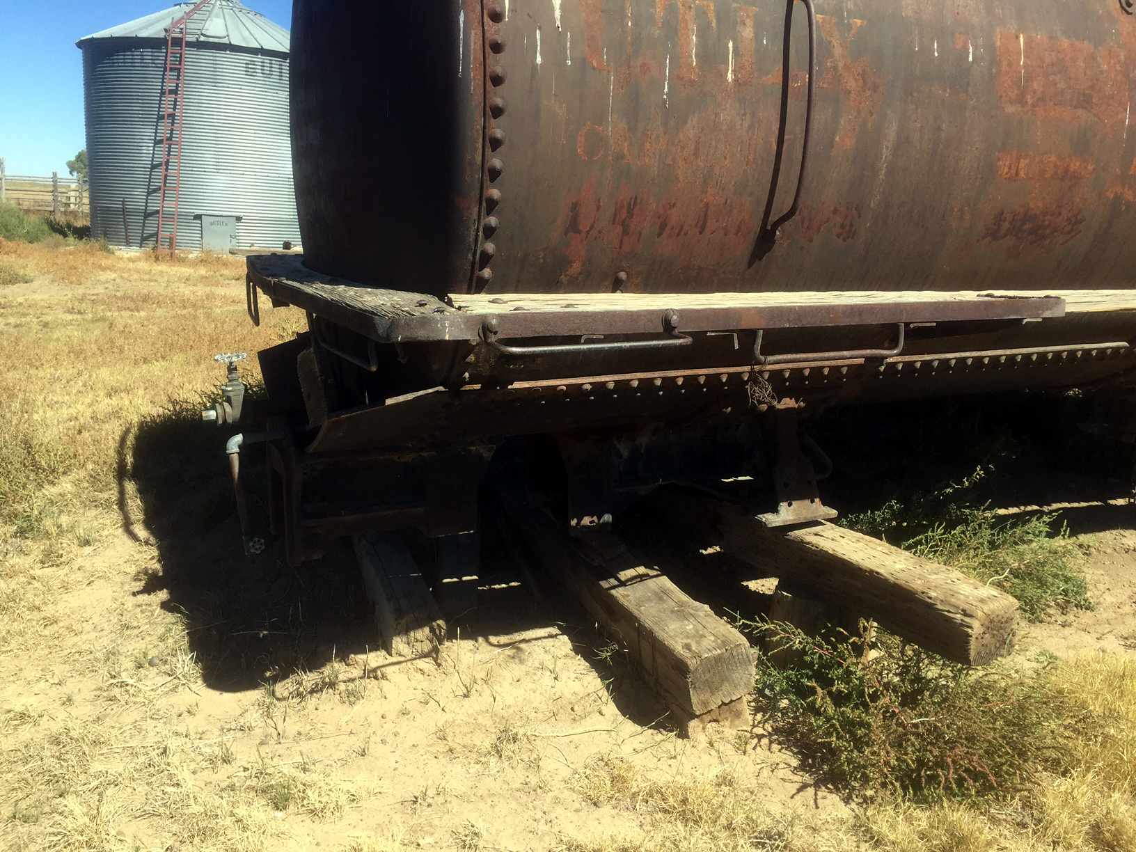

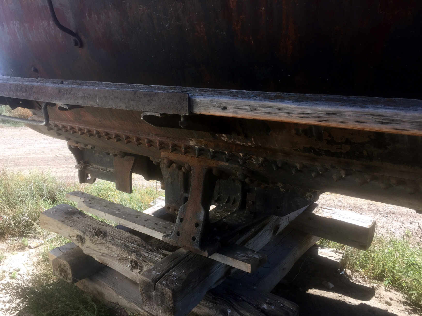

I can imagine this will be a long term resto, it looks pretty good but how complete is it, re brake rigging, reservoirs etc, and are there enough bogies available.
Were they tank bogies that the friends had a drive for to get more brasses??
Wayne from OZ
Edit - OK, this appears to be just the tank shell with no attached operational bits, but my question still stands. WRH

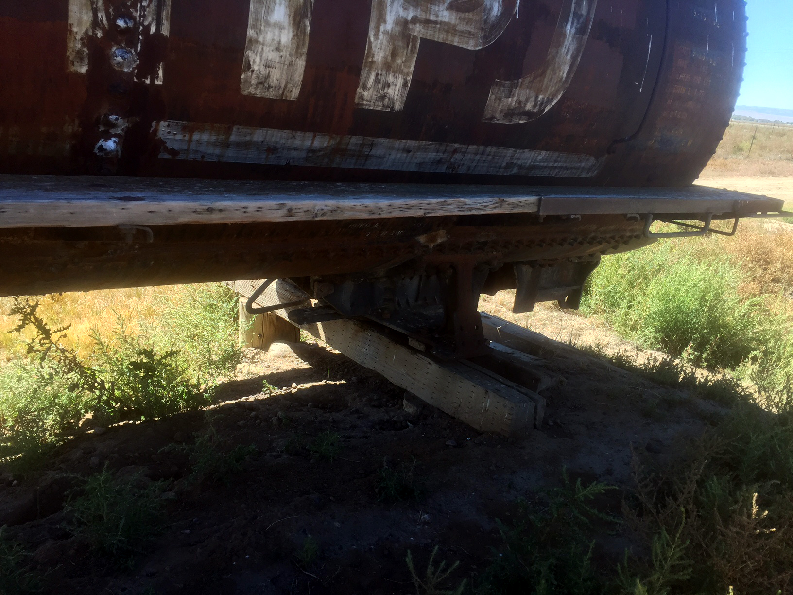

Hi Wayne, as you can see from the photos, all we are getting is the tank. Trucks, wheels, brakes, couplers, draft gear are going to have to be found. We have a pair of Bettendorf trucks under one of the water cars that are correct, but we will have to assemble a pair of UTLX arch bar trucks to replace them.
Yes, the wheel brasses drive a couple of years ago would be the same 4 1/4" X 8" brasses that all of the tank cars take, either narrow frame or frameless cars.
